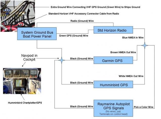

I am assuming you are talking NMEA 0183 and not NMEA 2000. You will need to run 3 wires from the chartplotter (it should have an NMEA 0183 output) down to the radio (it should have an NMEA 0183 input) - in, out and ground. I have a Standard Horizon, but the idea should be the same. You will note on the wiring diagram that the vendors use different colors for their connections.

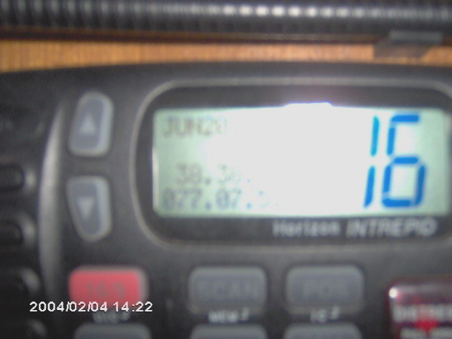

Also note on my wiring diagram that I only have the Humminbird or the Garmin attached at any one time as you can only have one master talker on an NMEA 0183 connection. :naughty:
The picture of my radio shows what it looks like when it works. :D I would also recommending (even though you are running the ground back down to the radio from the pedestal, that if you are near your ground bus, I would run a ground wire from there as well. The NMEA 0183 voltage levels are pretty low and just an RCH of ground will make the radio not see the NMEA sentences.
