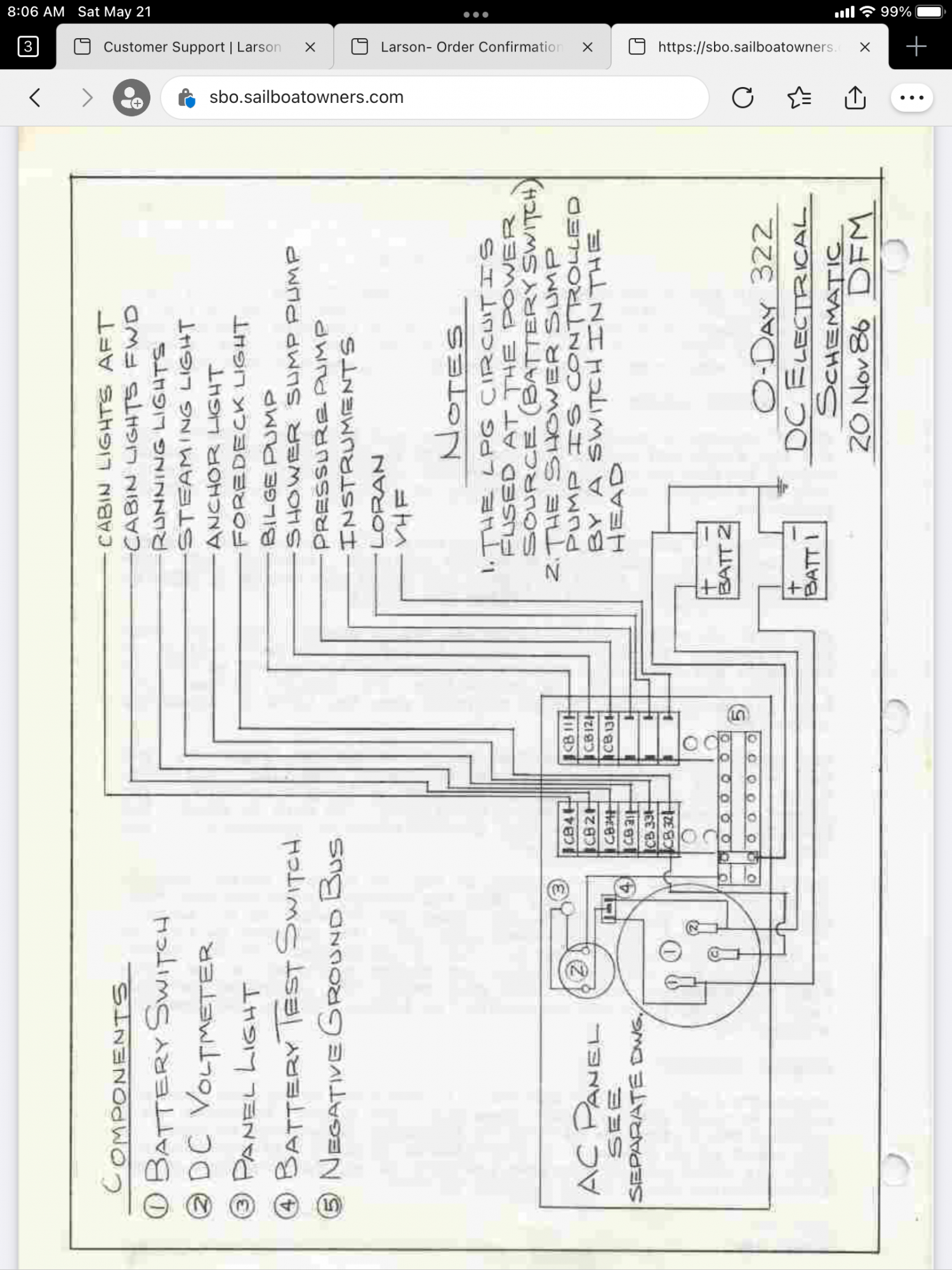

I have an 11A and would like to find a schematic particuler to the boat. Appreciate the assist. Hal
May 17, 2004
5,897
Someone here might have one, but be advised that boats of that age have likely seen multiple previous owners, each with their own ideas on how to change the layout. Some boats don’t even come out of the factory matching their wiring diagrams perfectly. So the original schematic may or may not be close to reality. You’ll probably have some detective work with a multimeter to figure out your configuration.

As @Davidasailor26 said, you might find someone who has a basic schematic, but aware that undoubtedly,it has been changed and bastardized by a PO.
i was working on my DC wiring yesterday. For some reason a PO wired the refrigerator with a 12-volt cig lighter outlet in the V berth and 2 other outlets were wired in with the AP…
So, I was abLe to install a new breaker, move the 3 outlets to their own breaker and separate my AP and refrigerator circuits.
The point is, I don’t think the boat had those cig lighter outlets when new, so they would not have been on the electrical plan at all. In fact, I just checked it and no refrigeration listed either…
Good luck…
Greg

Let me just add this to the mix; there is a wiring diagram that is what most people want to see and try to figure out things
"What is the difference between schematic and wiring diagram?
A schematic shows the plan and function for an electrical circuit, but is not concerned with the physical layout of the wires. Wiring diagrams show how the wires are connected and where they should located in the actual device, as well as the physical connections between all the components."
I've been around high voltage electricity all my HVAC career working on systems up to 480 volts and 12 volt systems are still sometimes a mystery to me!
This has helped me immensely when working on my own boat and helping a few other people
