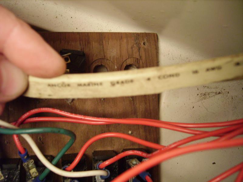

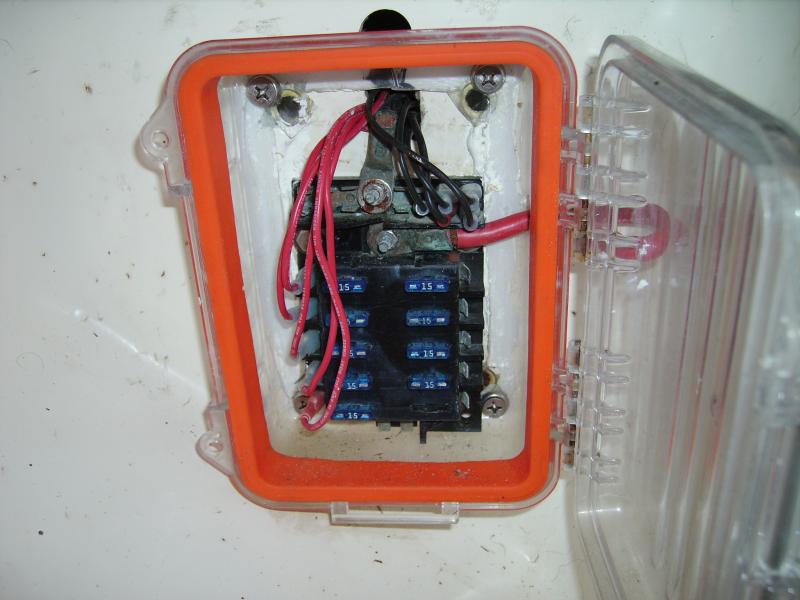

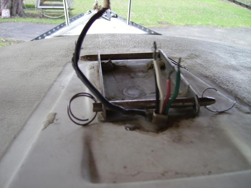

not sure if this will help,but will give you some ideas
on my 1981 hunter 22 there is a Ancor marine grade 16 awg 4 wire. the three wires on seperate fuses feed the masthead light the anchor light and spreader lights,and all sharing the same ground..
wiring was a complete mess on my boat,the pile in the one picture was all nonessential.
the pic of mast step shows my mast wire without the connector the large wire on left connects the mast to one of my keel bolts(lightning ground i suppose).
so far i have cabin lights , running lights and mast lights.still have to order a radio and float swithes for my bilge pumps.
