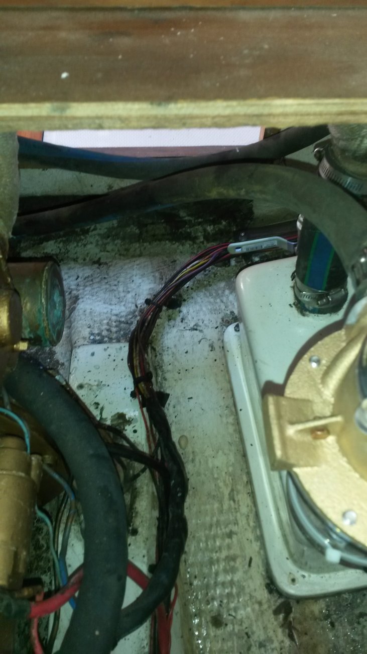

Is this where everyone's engine wiring harness is situated. It seems like it's very susceptible to water?

No it should be hung.
I’ll put even money on the PO having removed the gummy bear plugs, and didn’t have enough length to route it per OEM.

That’s where it is on a 1982 catalina 30 with the 5411 universal diesel (in our marina).
No mods done by the owner

I’ll take another look but it sure looks original along with the sails, pumps and engine. Thanks, Stu.

Looks just like mine on my 93. The trailer plugs have been removed by a PO and at the engine butt connectors were used.
The wire bundle is attached to the floor from under the floor pan until it gets to the engine stringer, then up on the stringer.

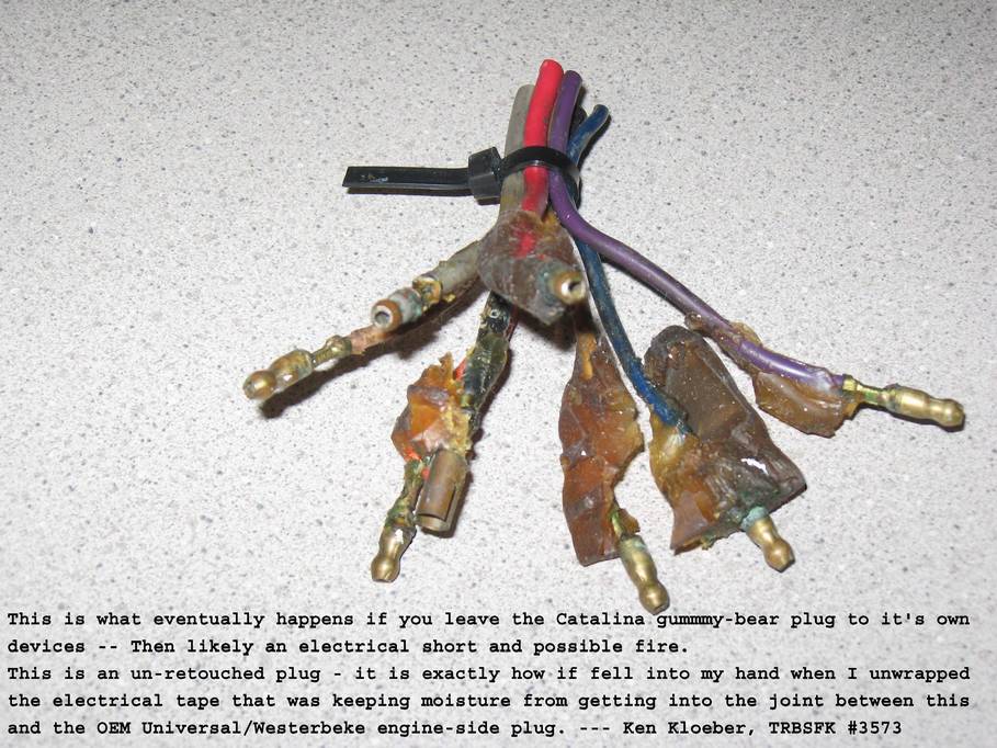

This is the gummy bear (and what happens to it.) I coined the term like 20 years ago and it caught on like, well, Gummy Bears.
In 1993 I had no clue of the hazard and cleaned up the plug terminals and expanded the males so they made a tight connection, and wrapped the plug joint w/ electrical tape to keep out moisture.
Fast forward:
