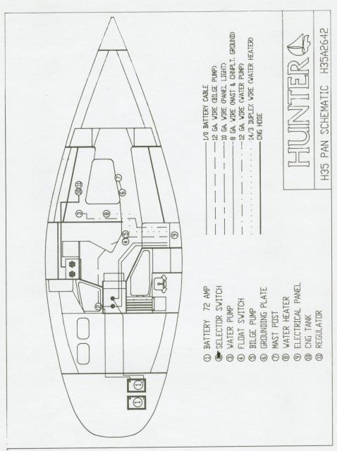

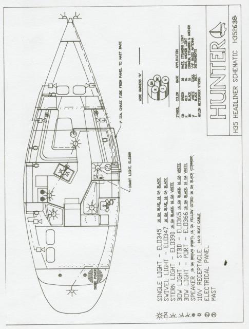

[FONT=&quot]Wiring route to V berth fresh water tank on a 1994 Legend 35.5?[/FONT]
[FONT=&quot]What is the best route to run wires from the nav table / electrical panel to the fresh water tank in the V berth? I've installed a tank monitor on the holding tank and would like to add the fresh water tank to the monitor. The boat specs show a wiring chase to the mast but I do not see a path to the V berth. Have any of you done this? Where is the secret passage? [/FONT]

diagrams
Here's a couple a diagrams to guide you.
