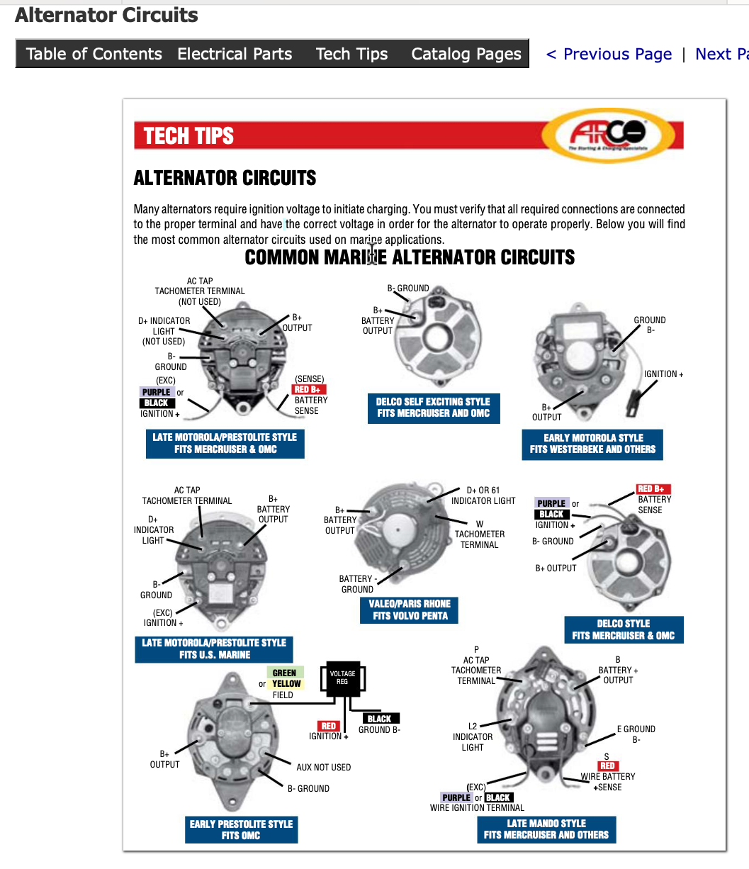

Often pictures help
AC Tap. is a signal pulse circuit that provides a data source for your Tachometor. You must calibrate your tach based on the number of poles on your alternator's stator. Just so you know, you do not need to use it.
What do you do if you do not use the AC Tap? You can install an analog sensor to generate a magnetic pulse signal from your camshaft pulley.
