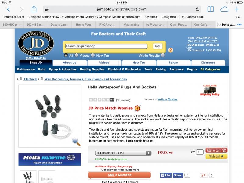

You will be lowering your mast at times right? Then you have to have a plug that will connect / disconnect. You strip the wires andconnect to one side of the plug strip the wires inside the cabin to connect to the inside part of the plug. Plugs come options for 2, 3 or more wires. If you're only running two such as a red and black and get the plug that handles two wires. They are very easy to use and once you buy it and get it in your hand you will instantly see how they work. These are the parts you need for that. I used them on my own ODay26.
