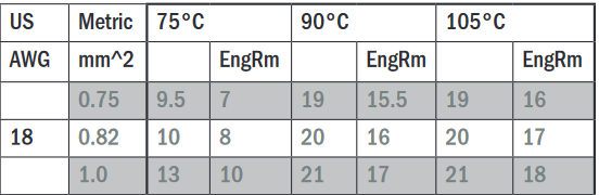

Regardless of temperature rating I would never attempt to push 20 amps through an 18 awg wire. It's too hot to handle even at 1500 watts
I don't think I understand this table, I'm assuming that an 18awg wire can handle 10amps at 75C, 20amps at 90C, and 20amps at 105C? I would have thought that the hotter the environment the less amps the wire could handle since it is unable to dump heat it generates. Or is it at 10amps an 18AWG wire will heat up to 75C and in an EngRm it only take 8amps to reach the same temp?
The temperatures are the heat rating of the wire insulator. For example - AWG 18 wire that’s rated for 75C can safely carry 10 amps (or 8 in an engine compartment). A different wire, also 18 AWG but manufactured with insulation rated for 90C can safely carry 20 amps (or 16 if in an engine compartment).
What you’ll also find is that most wire runs on a boat are long enough that voltage drop matters more than maximum amperage. Even though an AWG 18 wire can safely carry 10 amps, the voltage drop carrying those 10 amps for a 20 foot circuit would be 3.2 volts - way more than the limit for effective operation of equipment. So when you size the wire you need to consider both maximum ampacity and voltage drop.

The temperature is in reference to insulation of the wire and not the ambient temperature of the space the wire is in.
