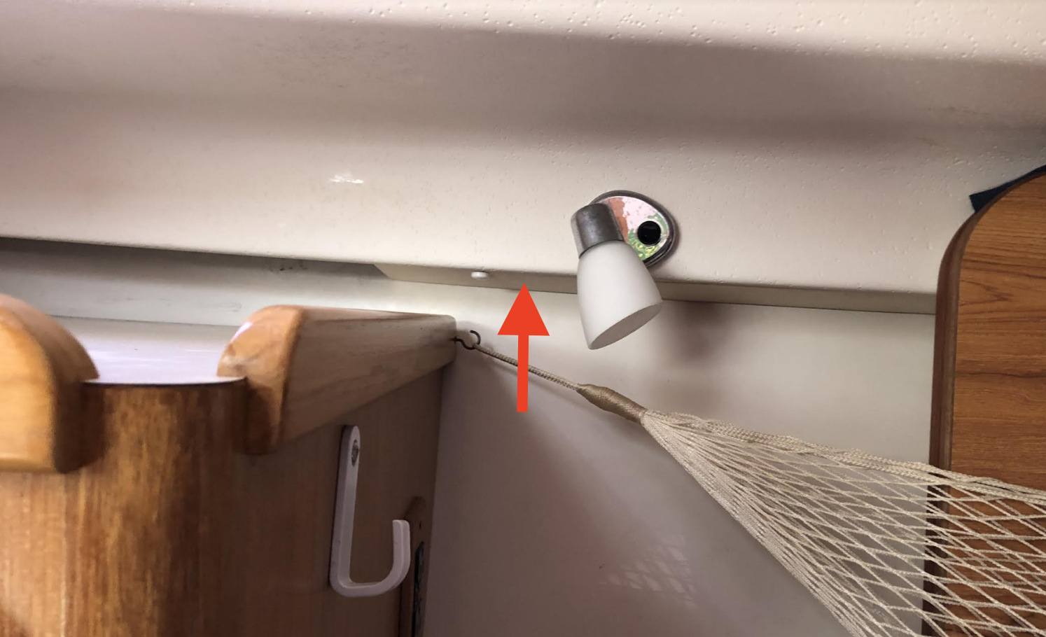

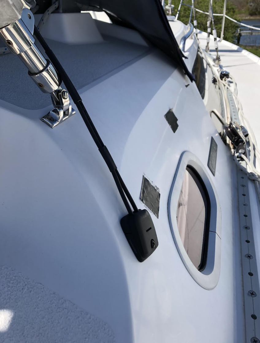

Finally found a wire route for the dodger solar, with the help of an inexpensive endoscope. This route allows you to run wire from the dodger to the nav station electrical panel without penetrating the headliner. From the aft berth, there is a path from the starboard wire raceway upward into the space between the inner and outer deck panels. Start searching upward from just forward of the interior light (red arrow). This space leads all the way to the dodger support bracket. I chose the flat spot nearest this bracket, just behind the port light, and used the new DS-HD6-BLK double wire cable seal from Scanstrut.
The whole assembly is concealed by the dodger side window, making a nice compact installation. The finishing touch will be to fix the missing dodger studs that are presently covered with duct tape :(
