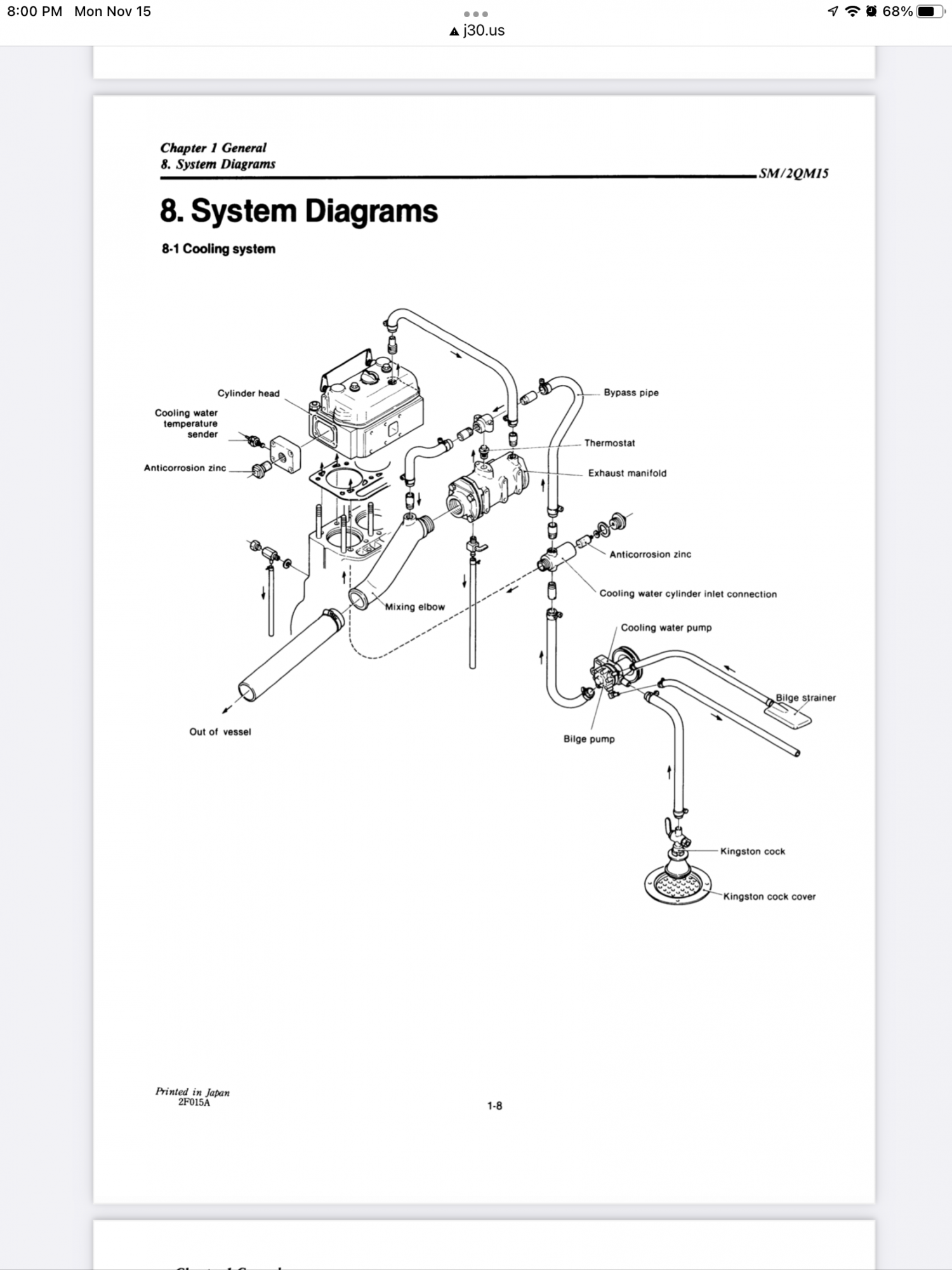

Not seeing the drain valves in the service or parts manual diagrams. Any help locating it would be appreciated.
They are both shown on the drawing 8-1 above. Look at the mixing elbow, they are shown on either side of that on the drawing. They each come with a short plastic hose that aims down at the bilge, but the hoses are usually are lost over time.
