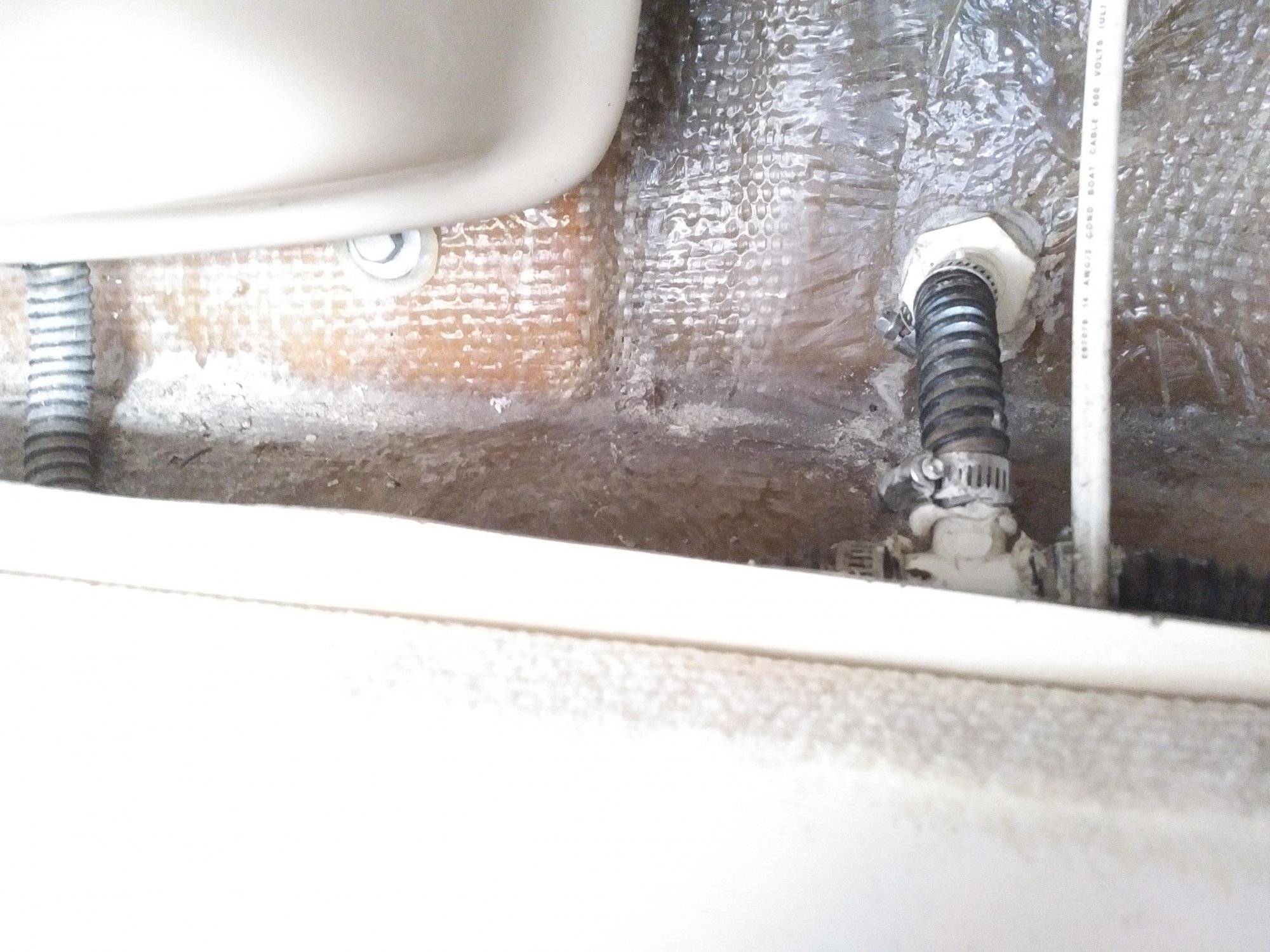

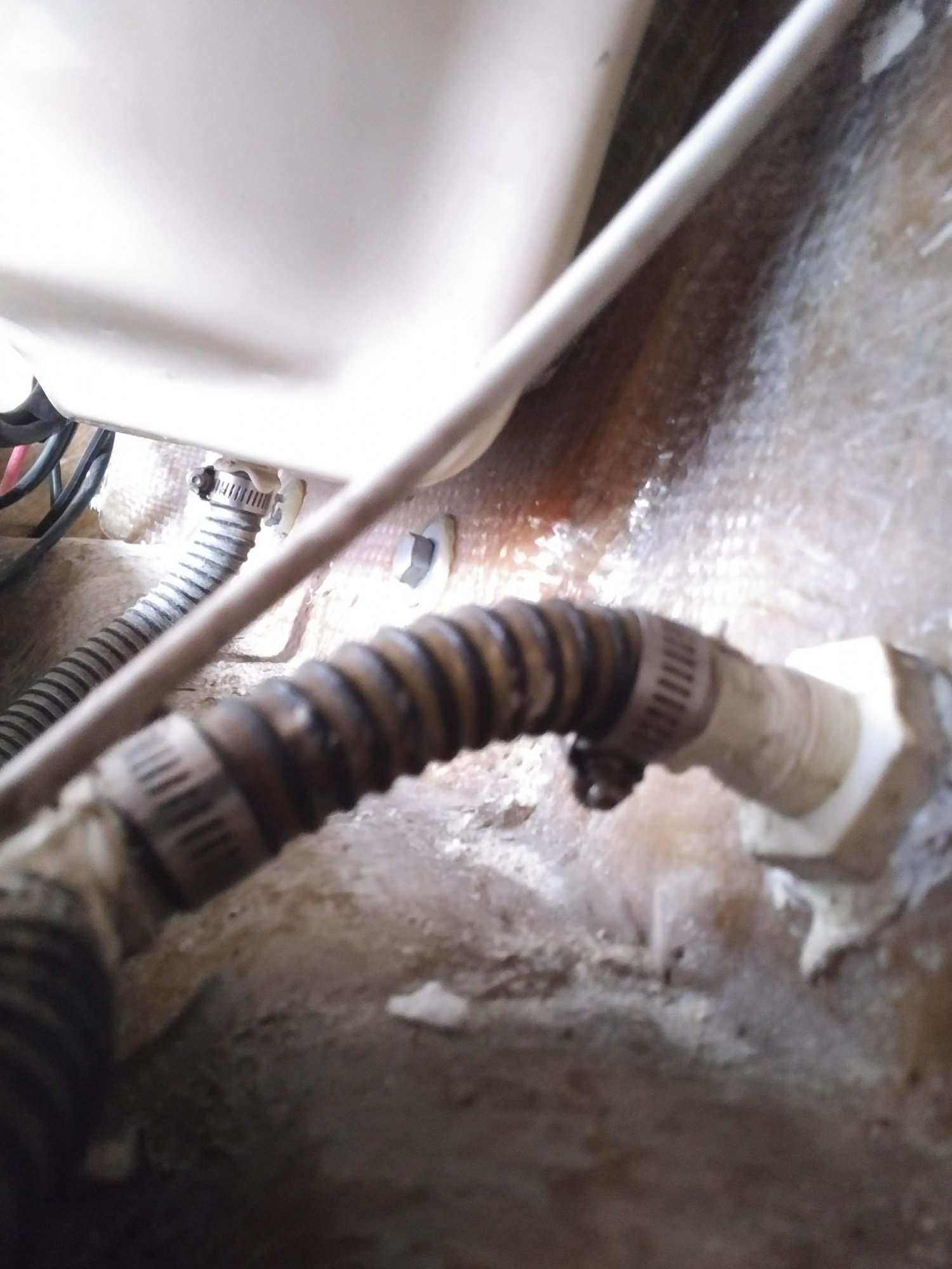

I live in Ottawa, Canada where the winters are cold. I have a 2005 MacGregor 26M (with a sliding galley) and every year I try to improve my method of winterizing the aft scupper. The cockpit and aft deck drain into the outboard engine well, and there is a small scupper in the bottom of the well and the output is through the transom a little below the well and to the port side by about a foot. The connection between the well and the output is a flexible pipe that goes BELOW the level of the outlet (see photos), which means there is always standing water in it. In addition, the sink on the sliding galley goes through a long flexible tube that eventually is routed in the aft bilge before rising to a T connector just below the outlet (see photos). Any water going down the scupper from the engine well has to fill up this drain pipe to above the level of the scupper output before any will go out through the scupper!
The way I winterize this scupper at present is to plug first the scupper and blow out at the sink, then reverse, plug the sink and blow out at the scupper. Then add anti-freeze and repeat. Then plug the scupper in the engine well and immediately store the boat in it's unheated dry barn, where there will be no water accumulation in the plugged engine well. If the boat was outside with a cover over it I could imagine that over the winter there will be some accumulation of water in the engine well.
Does anyone have a suggestion as to how best to winterize this aft scupper?

Don, I agree that covering the boat is an important part of winterizing the boat. In my case I store it in a weather tight storage shed. The other half of the winterizing is removing the standing water. The current routing of the scupper pipe has a significant portion of the pipe below the level of the outlet. By way of comparison I have a scupper in the anchor locker which has a pipe that has a continuous downward flow with no standing water and I do nothing to winterize this scupper other than ensure there is nothing blocking the hole and water runs out freely.
I had been thinking of redoing the piping in the aft scupper. First separating the sink drain from the scupper and then rerouting the scupper pipe to a new outlet that I would place a little lower in the transom than the existing outlet to give a downward flow and eliminate any standing water. In this scenario the sink drain would be the only thing going out the existing outlet and it would have a significant amount of standing water in it, but it could easily be winterized by blowing out and adding antifreeze.
My main problems with redoing the scupper output to a new outlet is I don't have much freeboard to lower the new outlet and I haven't found fixtures that would ensure a continuous downward flow with no standing water.
I was wondering if anyone with a MacGregor 26M had successfully tried this solution?

My lack of clarity probably isn’t helping you but if I understand correctly, two possible solutions might be:
1. Displace any water in the scupper drain line with antifreeze after which covering should preclude any water entering, or
2. install a T fitting with a valve at lowest point in drain hose and leave valve open.
Don, Thank you for this. Your solution 1 (with the addition of plugging the scupper before covering) has been my method of winterizing since I've owned the boat. I plug the scupper because if water does get in the boat in spite of the cover, then a frozen engine well is a lot easier to deal with than frozen pipes below deck. But as Ken pointed out ice in the engine well can lead to big problems "....to prevent any ice build up from possibly cracking the well itself. .... I saw what that can do to a friends boat."
This part of the MacGregor is lacking in practical design, again Ken sums it up "Not the best set up for sure." So I've been looking to improve the setup. I think the first thing to do is separate the sink drain from the scupper, having a separate outlet for each. Under this scenario your solution 2 could be a good alternative to winterize the sink drain on it's own. Now I just have to arrange a free flowing scupper with no standing water. With temperatures of -25 Centigrade (-13 Fahrenheit) that we have been getting recently, you don't want any standing water in your boat or pipes!
Brian
