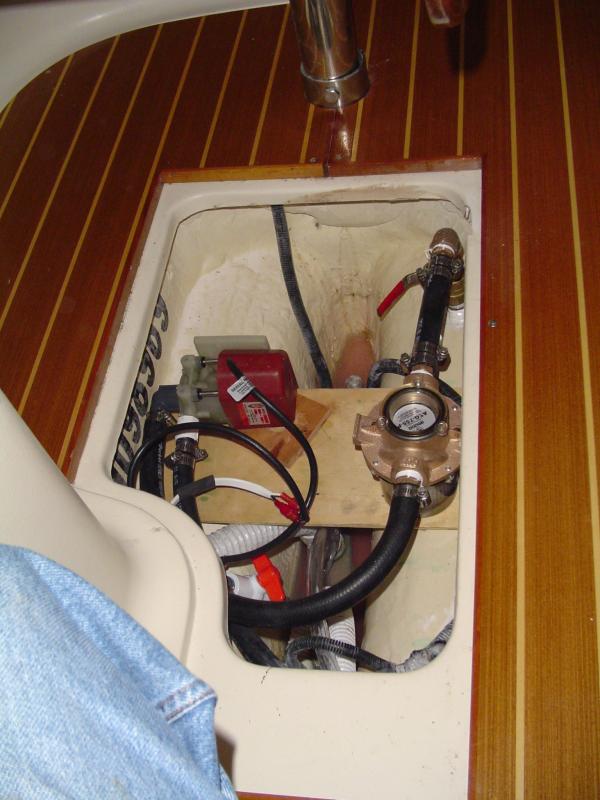

I always have trouble priming my AC pump to pull antifreeze through. It's especially tough when working alone, because it's nearly impossible to open the bleed valve on the pump while pouring antifreeze down the input hose. I've resorted to using a spare pump to boost the antifreeze through the circuit. I put the output of the boost pump onto the input hose, then I can pour antifreeze into the boost pump and run the AC to pull the antifreeze through. Much easier and faster that way.

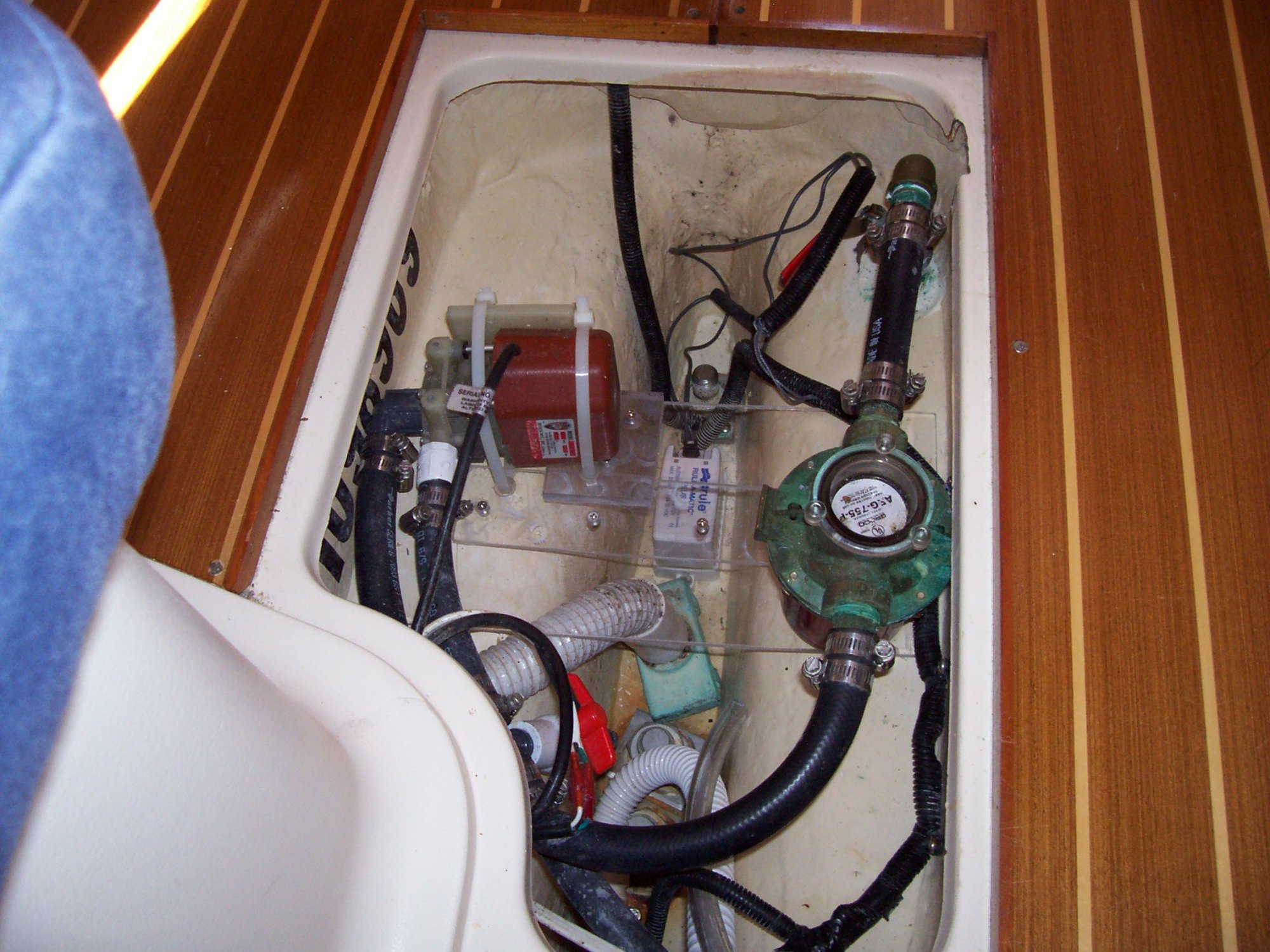

I have used a 5 gal bucket with a drain installed to winterize both my engine and my AC. I place the bucket on a seat or box set well above the pump, add the needed amount of antifreeze and activate the pump. Gravity feeds the pump.

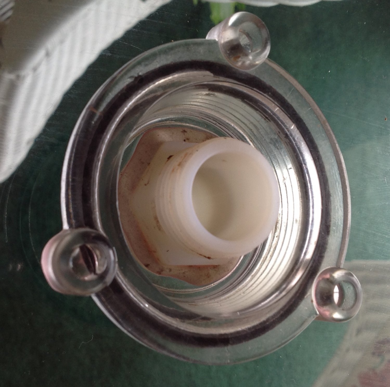

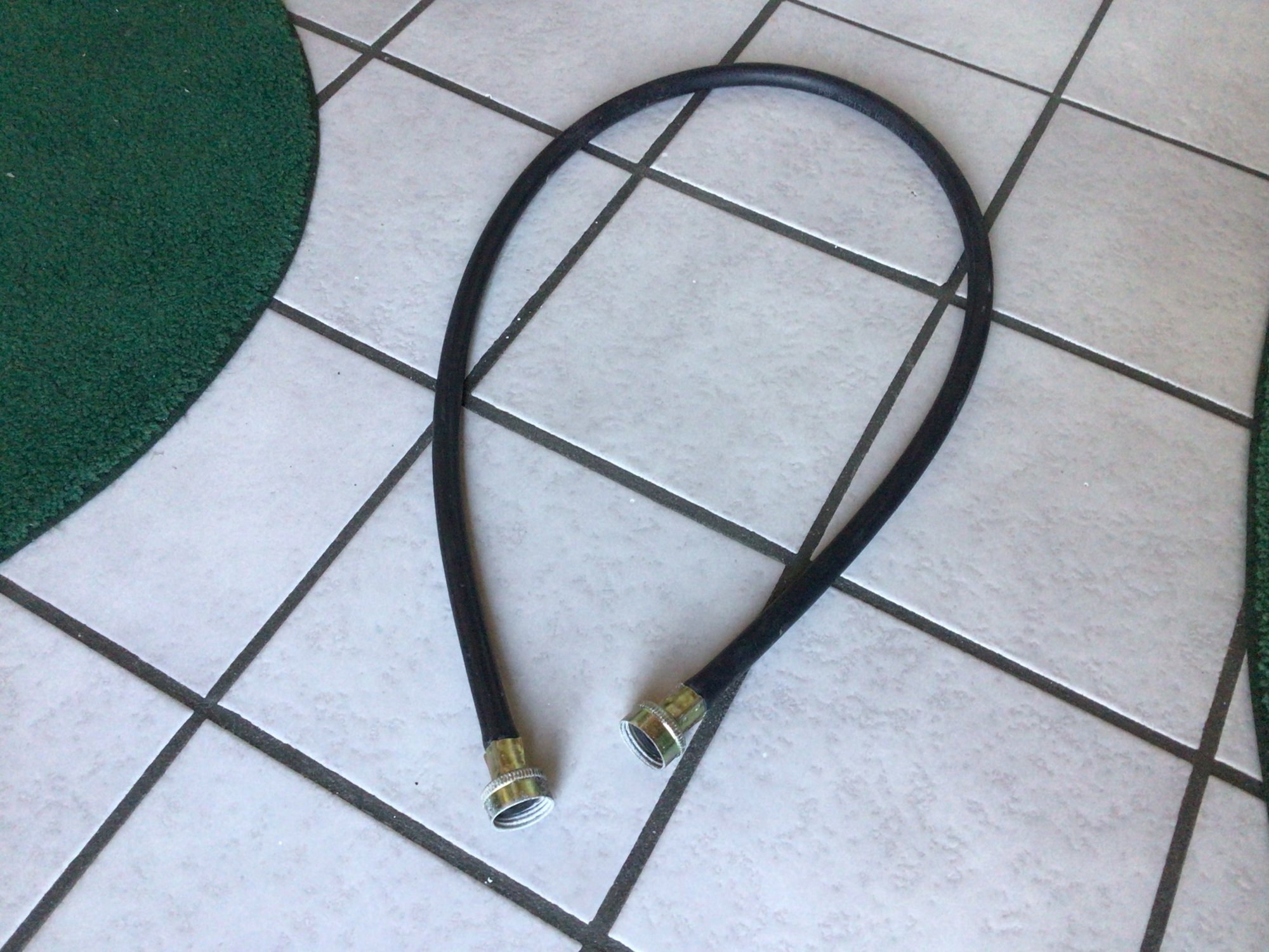

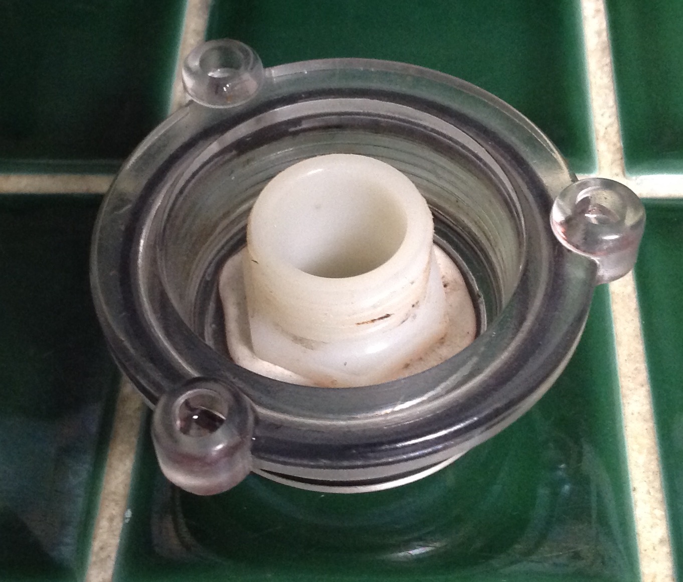

I don’t involve the pump itself at all, except for it‘s use as a pump for the AC system.
I bought an additional cover for my Groco Strainer. Drilled out a 3/4 Inch hole in its center and epoxied in a garden hose fitting.
With the strainer being before the pump, I replace the solid cover with the “hose adapter fitted” cover, connect a “washing machine” hose to it and the other end to a 5 gallon bucket with the same fitting I epoxied into that.
I fill the bucket with fresh water to rinse out the system and then pour my antifreeze (the pink stuff) and simply pump that through.
When done I top off the strainer with antifreeze, replace the solid cover and thats it.
Like “JohnT“ stated, just put the 5 gallon bucket on the seat above the AC Unit and let gravity and the pump do their jobs.
The washing machine hose is a smaller diameter hose, so I don’t use it for the engine winterizing. But for the AC Unit it has enough flow.
Here are pictures of my set up….hope this can help you out.

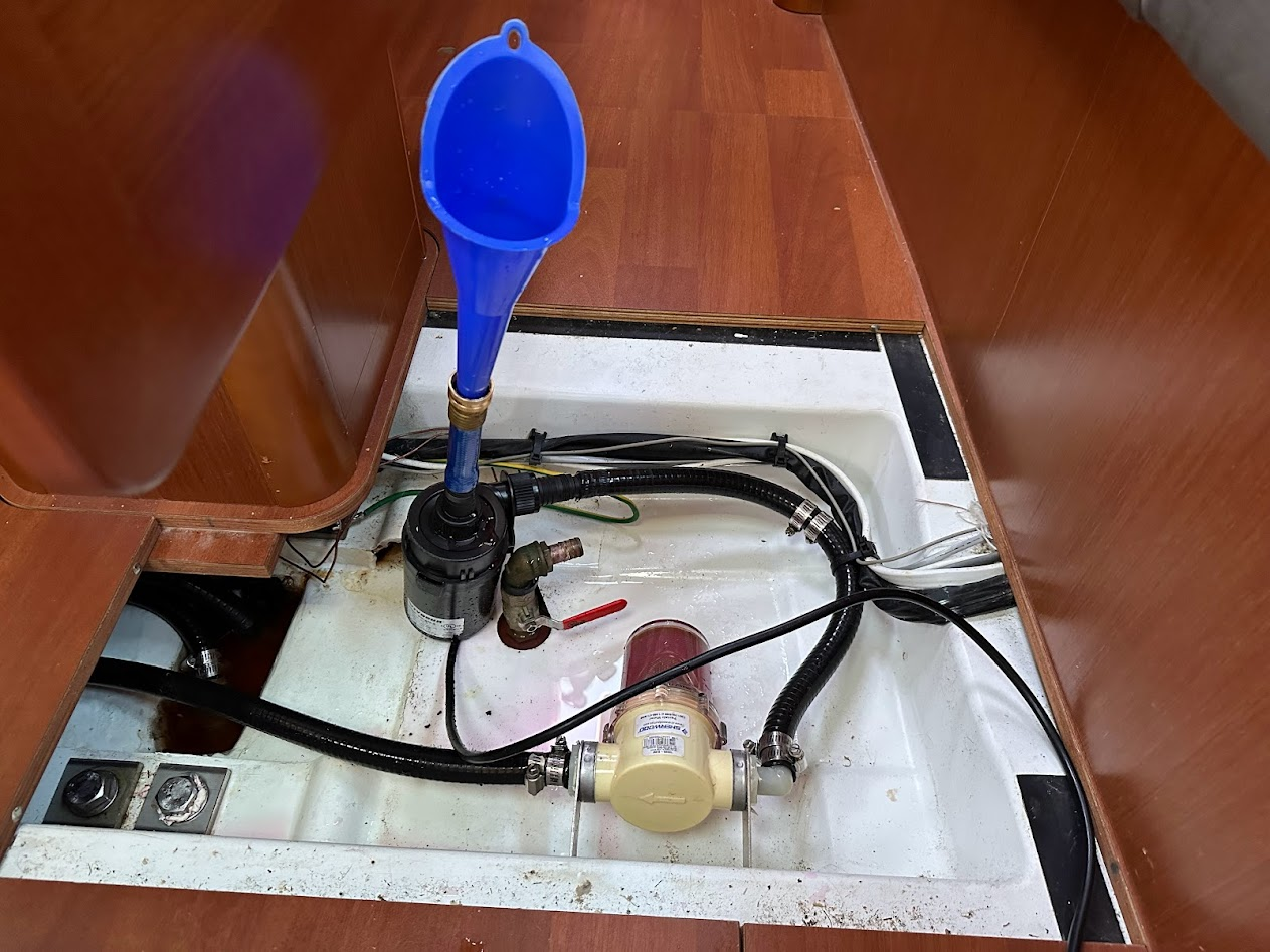

Thanks, Sailors! I used a small sump pump in the bucket to push the antifreeze into the system. Worked great. Appreciate the inputs. Now how to access the darn raw water impeller... :(
