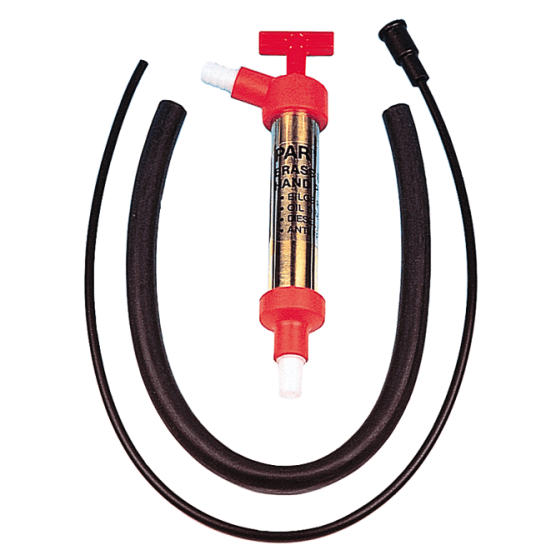

1. With the seacock closed, attach the outlet of a manual utility pump to the raw water hose leading to the seacock. Use hose clamps to secure it.
10EA0F07-BA39-42C3-95E7-7D0DB7D31C62.pngJabsco 34060-0010 Utility Pump
2. Attach a hose to the pump’s inlet and insert the other end into a bucket of antifreeze.
3. Pump away until saildrive uptake is full of antifreeze.
4. Close seacock and disconnect utility pump and reconnect hose to seacock.
*Note standby ready to close the seacock quickly if the upward force exceeds the utility pump’s designed specifications to contain it.
Either way, I am not sure that the antifreeze will remain in the saildrive for more than a few hours but it may satisfy the insurance company if you have to make a claim with them. And the utility pump method will save you the cost of a quick haul.
