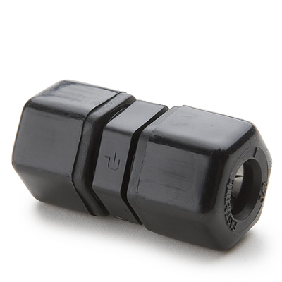

To winterize, remove the filter and throw it out, leave the housing cover off, and bypass it. Bypassing is easy with the plumbing fittings and tubing I use, not tools necessary, I'd just use a union fitting where the filter would be.
Note that the nuts on this union would already be on the tubes going to the filter, I would just need the middle part.
