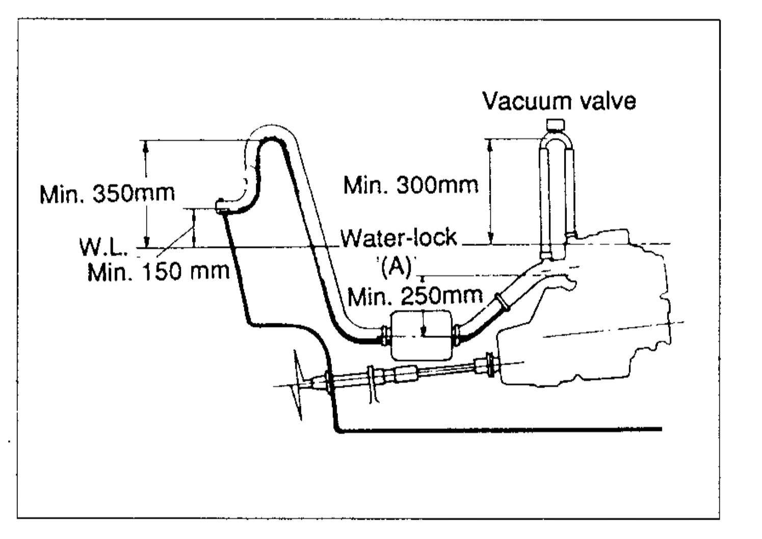

I have a 2004 373 and have always run antifreeze thru. I would like to drain instead this year but am concerned about any water remaining in the system.
Will vacuum valve drain?
What about water in the hose after the muffler and in the muffler?

The Yanmar instructions concern only the engine, NOT the exhaust system. So draw your conclusions!

If you leave plain water in the water-lift exhaust it may breeze and burst... mine is plastic. Spring will have a whole bunch of new fun if that happens...... I blow out all my fresh water lines with compressed air... engine I flush with fresh water for an hour then add the purple stuff.
