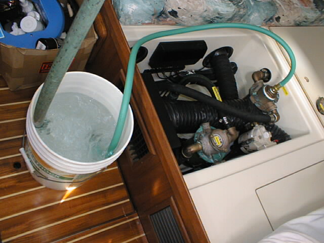

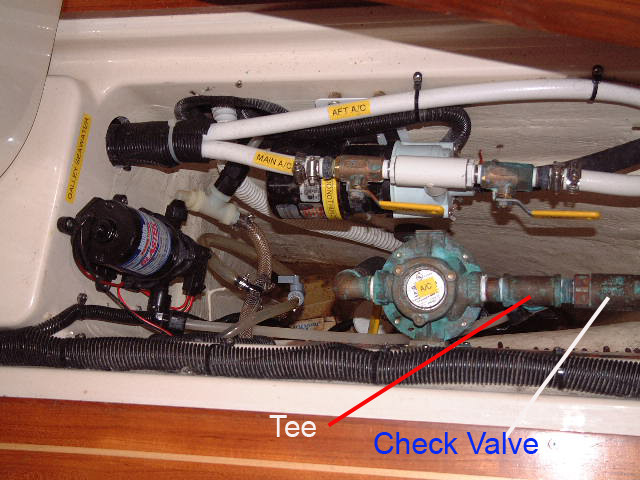

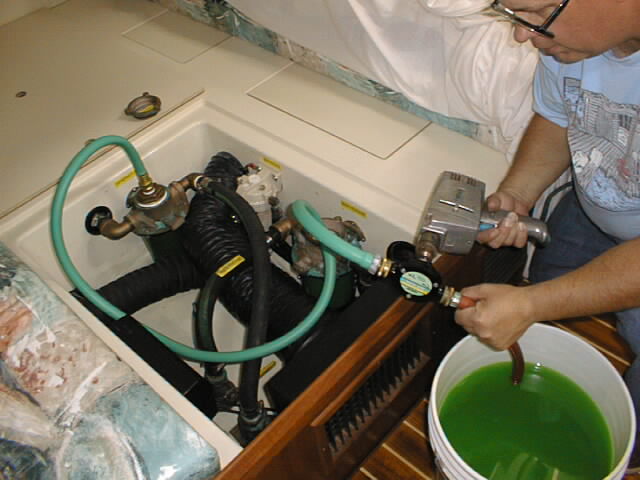

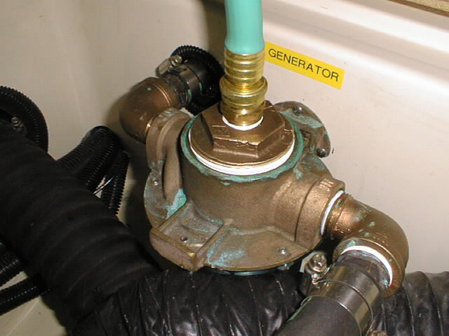

I winterize just like my engines, except that I use the RV antifreeze if I don't have the PE glycol available. I have an adapter that I made for my Groco raw water strainer that accepts a garden hose. I fill a 5 gallon bucket with fresh water and run the A/C for 5-10 minutes to completely dissolve and flush out any salt deposits. Then I swap the hose to another 5 gallon bucket with the antifreeze. Years ago I installed two shut-off valve in the lines going to each A/C and I add the antifreeze to each on in turn. In this manner I don't pour antifreeze out of one while waiting for the other to begin to show color. I figure it saves on antifreeze as well as having my spotter on the outside having to watch just one outlet at a time.
The pictures below show my generator in play, but the same system is used for the A/C. The last picture shows the A/C with the two shut-off valves.
I like that fitting you have for your strainer.... would like to find something like that for my beneteau strainers to eliminate the need to remove hoses.
