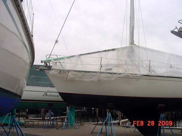

I like the idea of using the mast as a ridgepole but agree with the notion of supporting it in the middle. If the 'roof' made out of the tarp is steep enough you should not get much snow load. But be sure the tarp is INSIDE the lifelines-- the stanchions will rip any tarp.
My mast is down pending paint, so I don't have the same situation.
For my H25 I made a frame out of 1-1/2" PVC, using glue welds for the T fittings and otherwise bolting segments together to make it easy to take down. The bottoms of the legs are drilled and tie-wrapped to the toerail; but if I were to make it over I would put T fittings at the ends like feet. It has 6 legs. PVC comes in 10-ft lengths; I cut each piece in half so thus the legs are 5 ft long and can be covered (nearly) with a 10-ft-wide tarp. The ridge pole sort of goes up and down because the width of the boat changes and the legs stay at 5 ft; but this is only a little ugly and hurts nothing; and the tarp therefore is lashed more or less evenly to the toerail. This allows for air circulation and all water runs down the side deck and out the scuppers or aft end.
The front and the back were originally line. I used the vang tackle to pull it tightly down to the bow. The back now has a PVC leg because I had to remove the rope 'stays' there to do work.
I used the heavy-duty silver-and-brown tarps from Lowe's last but they are expensive (10 x 12 is like 19.99) and only last 2 seasons max (one ripped before the first winter started). The blue ones are utter trash, fit only for dropcloths when painting the bottom (and thus disposable). I 'shingle' against the prevailing weather, lapping the weatherward one over the leeward one about one hole's worth. I will replace the tarps this season with cheaper, green ones from Camp-Mor in Mahwah NJ (they are on the web). They have a 10 x 20 for like 19.99 and I will buy two and lap them longitudinally (one lashed close to starboard lapped over the other one that is lashed close to port).
DO NOT, EVER, tie the tarp to the jackstands or props under the boat. EVER.
On my H25 part of the bow sticks out but it is more important to 'sew' up the after end because the yard parked my boat butt-end to the weather. If at all possible always have them park you nose-to the weather!
When I take off the tarps I have now I will wrap the ridgepole with pipe insulation as all sharp corners, even the tight radius of the pipe, will cause fatigue of the tarps. When screwing pipe together I drill one hole oversize and recess the heads of the bolts INSIDE the pipe so that the bolt heads will not tear the tarp. This is vital. Wet snow weighs enough to tension the tarp enough to cause fibers to just give up.
Next year I will have the boat stored with the mast up and will invest in a nice canvas boom tent with zippers for the front of the spar and access at the lifeline gate. The rest of the boat will remain uncovered but aside from covering the varnished foredeck hatch this should be all right.

isaksp00-- two things to your two questions. :)
I tried to keep the PVC legs to about 5 ft so I could use one 10-ft piece for 2 legs. So the ridgepole goes up and down a little. Each end up there has a T fitting. The legs do NOT mate exactly port-to-starboard as there is no PVC fitting to allow that. So the ridgepole is in sections, 3 ft, 4 ft, 6 ft (that one bent or melted like a swayback mule) between the T fittings of the legs.
At each T fitting I either glued in a short bit of ridgepole (to the next leg) or fitted it dry and then drilled straight through both pieces of pipe, the ridgepole and the T fitting. In some places I just made sure the hole was horizontal so that the heads of the bolts (I used 10-24's) and wing nuts on the other side were NOT interfering with the tarp, because they will rip it.
In other places I had to drill straight down into the 1-1/2" pipe (like for a 2x4 vertical leg in back). I drilled the #10 hole through and then enlarged it to take the whole head of the screw and the screwdriver, then bolted it with the screw head and washer INSIDE the pipe (you reach down through the larger top hole with the screwdriver). This keeps a bolt head from ripping the tarp.
Using PVC is CHEAP. I think this whole thing cost me about nine dollars. The bolts at Lowe's were more expensive than all the pipe pieces. (I used a lot of PVC for plumbing inside the boat too-- so long as it does not freeze with water in it, it's ideal. But don't use it for seawater or engine water.)
When I get my new tarps I will wrap the ridgepole with pipe insulation as the bits of carpet and engine-box insulation I used as some points were of little help. ANY bend will stress the tarp. At the front end I have to use a 22-degree elbow to add a forward leg because the tarp bending over the end of the ridgepole gets cut there. The forward leg gets lashed to the stem fitting. Over the cockpit I have two rope 'stays'-- one of these will have to be the vang this year because the forward leg isn't adjustable. I generally tension it like it's a piece of the rigging! ;)
Without a toerail I would locate the legs at key places-- the genny-track car, the stanchions, etc, and lash or tie-wrap them securely so they won't kick out. Use a T-fitting as a 'foot' (it's easier to lash to something). So long as you keep the tarp tight (and visit your poor lonely boat a few times a month for the winter) you'll be surprised how little snow-load problems actually matter.
As a rule try to negotiate with the yard crew to locate your boat nose-in to the prevailing weather in winter-- it makes most of this much easier.
