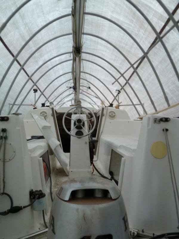

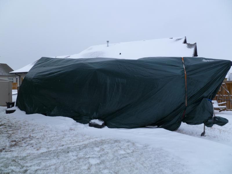

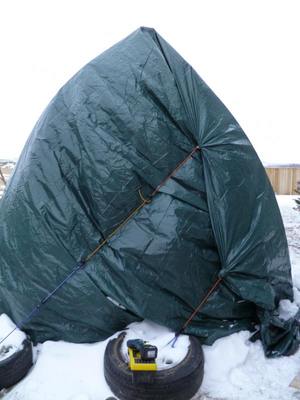

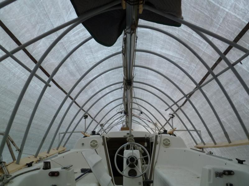

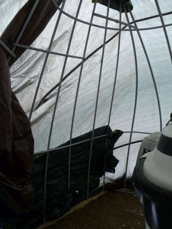

I will be wrapping mine up very similar to Dave. I had a Mac last winter and these pics show how I did it. I made the frame with 1" pvc so I could access the interior to do some work, if required. It really helped in the spring. I put in a samall heater and could do some stuff inside dispite the cold, rain or wind. I folded the tarp in such a way that I acually had a back door (pic 4). It was vey comfortable inside, I would simply turn the heater on, and then go in 1/2 hr later and it was toasty.
Pic 1 shows how it was tarped. I pulled it tight and used old tires to hold the tarp down to the ground. This prevented a draft coming in from the bottom. The other key is to also have the bow tightly wrapped to prevent the wind from entering the tarp and making a giant kite out of it (pic 6). Pic 2 and 3 show the ribs of pvc from the inside. I actually extended them and the tarp so I had 6' past the stern so I could have room for a table, saw etc... Basically, from the end of the mast down (pic 5). Pic 4 shows the back door Two bungees held the back of the tarp down. I would only have to unclip the one bungee that was hooked to the tire, to open up the back. So it was a completely sealed 'cocoon'. It took one saturday, about 6 hrs, to constuct...single handed. I'm not sure if I will go to this extent this year, only due to my lack time. Don't forget the crutch to support the mast as Dave mentioned.
