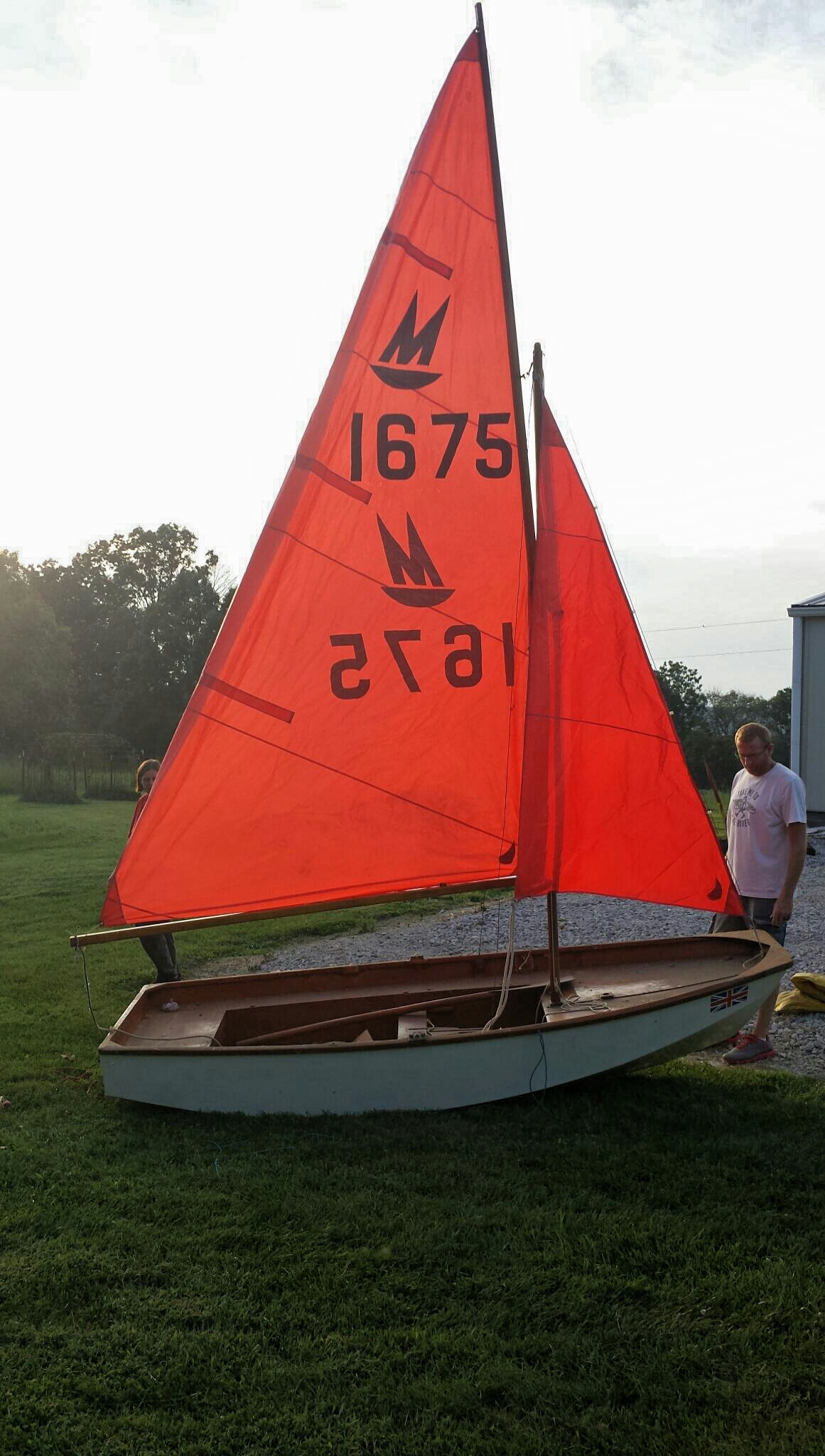

That will give me time to work on our new boat, a 1964 Mirror sailing dinghy we got from the original owners. Meet Miss Friday
She was built in 1964 in England by the grandfather of a friend of ours. His parents inherited the boat and sailed her as often as they could. She was brought over when his dad was transferred her for work and has spent the last 20 years hanging in his Dad's garage. His dad recently passed and his mum is moving into a condo so the boat had to go. She really wanted it to go to someone who would sail her again. That is where we come in the picture. We went out and checked her out and she was all there. I had her rigged and ready to sail in about 10 minutes. The sails are original but really pretty nice and more than adequate to use. I am a sucker for a story so I had to have her. Once they told me what they wanted for her I almost felt guilty but I knew that she was probably going to need some TLC as she was starting to show her age. We loaded her up and took her home. His mum was in tears when Adrian told her we were going to sail her again and she was welcome to go with use anytime.

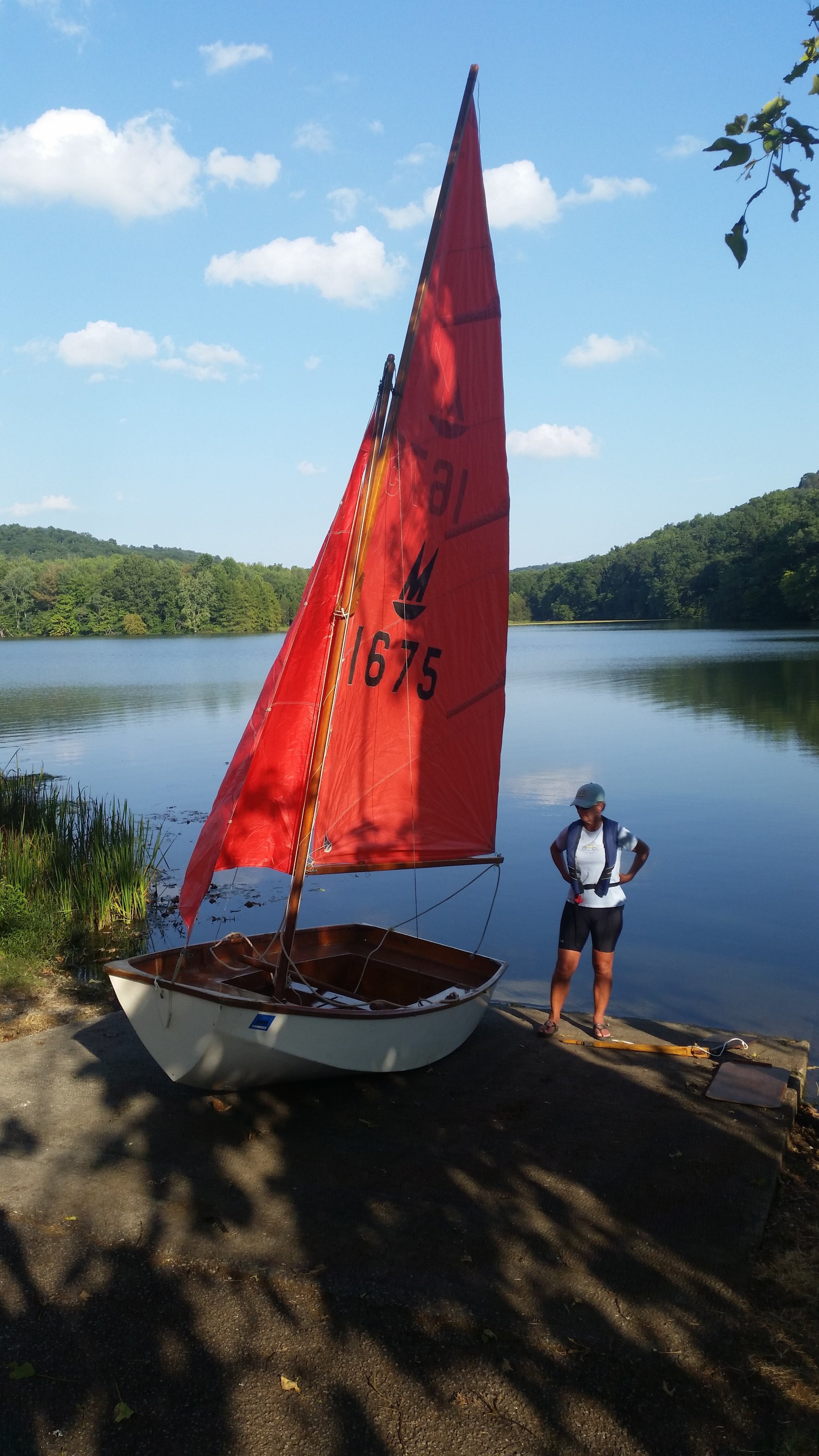

Well she has a few issues as any 50 year old wood boat will but she is all there. I made a few quick repairs to her hoping we could at least give a her a test sail before I tore into her. We loaded her up and took her to a local lake to give it a go. Had I been thinking I would have sat her in the water to leak check her first but instead we rigged her up and then set her in the water.
It was short lived as water was running in around all the nails that had been used to hold the toe boards in the bottom of the hull. Just as I feared. Oh well, it was good practice. She is now sitting along side the Memory Maker patiently waiting to be brought into the work shop for a complete hull strip then re-glassing with epoxy. Back when they built them in 64 they only glassed the seams and then varnished the hulls. I will use 6 oz cloth over the entire hull and West Epoxy over that. Cindy wants her to be a light blue on the hull so she will get her wish. I will build a small trailer for her to ride on and by next spring we should have a neat little boat to sail on lakes closer to our house. Plus with grandkids now we have a boat we can infect them with the sailing bug!
