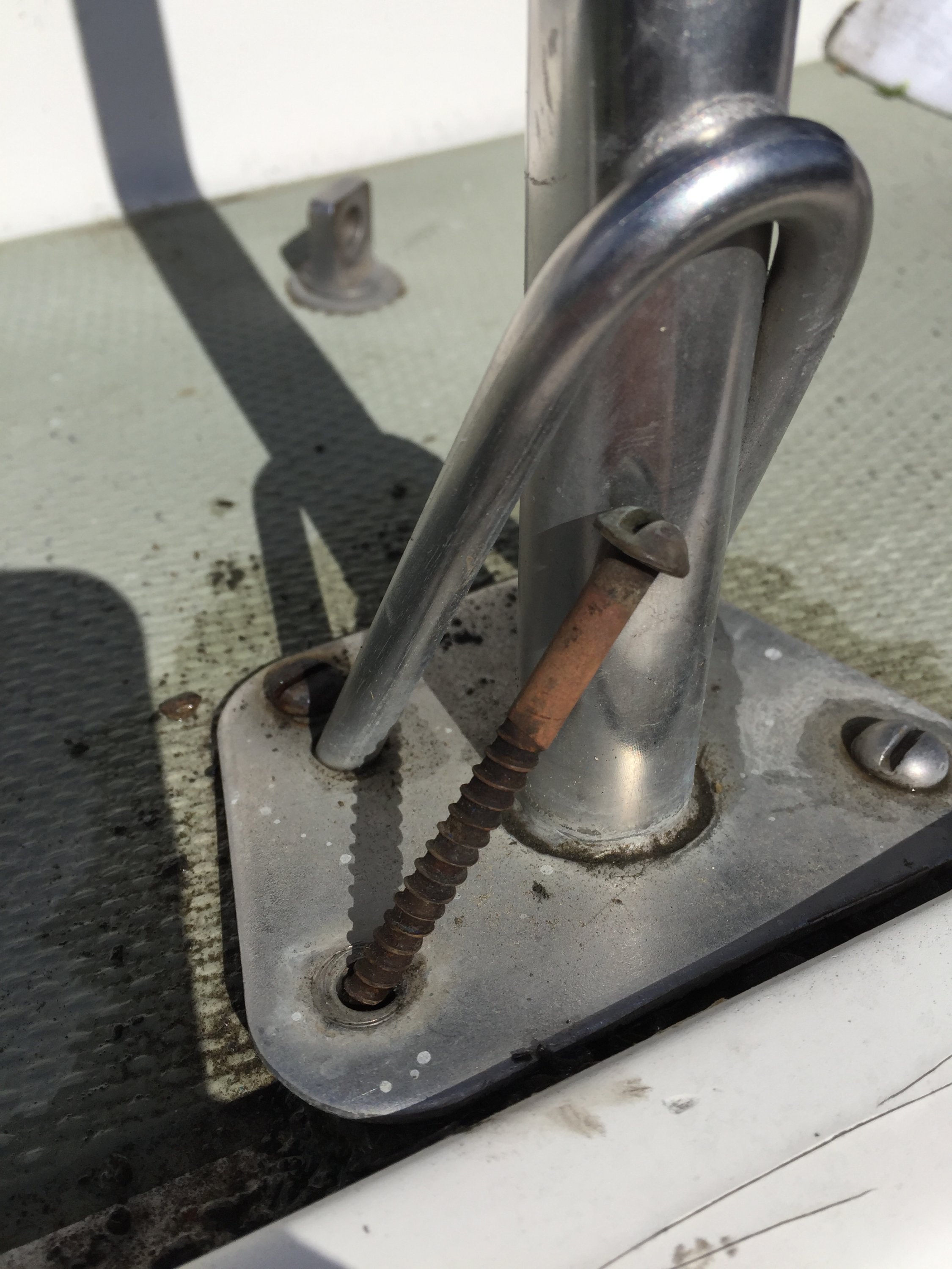

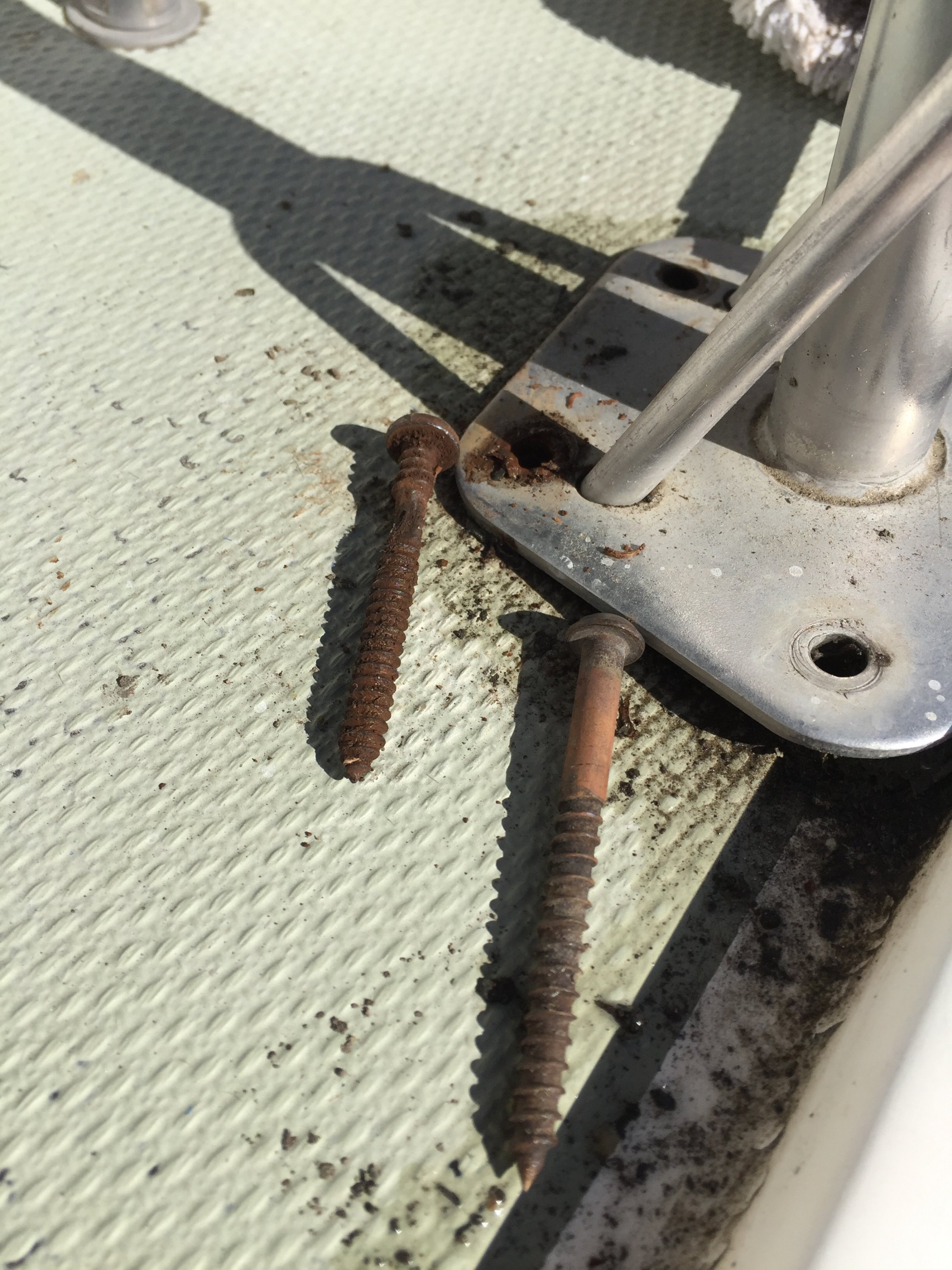

Well, I don't know much about much, but the '73 I bought 1/16 had a lot of water in it after a rain. First off, she was barely covered with a tarp. Sitting fairly level, I'd find water on the deck after a storm.
The culprit for the majority of water was the sink drain hose, which I found disconnected from the sink and rotated 180°, emptying the cockpit scuppers into the bilge.
Afterwards, I began to suspect deck hardware, since the water generally looked rusty. I need to rebed all my hardware. Here are photos of the worst stanchion:

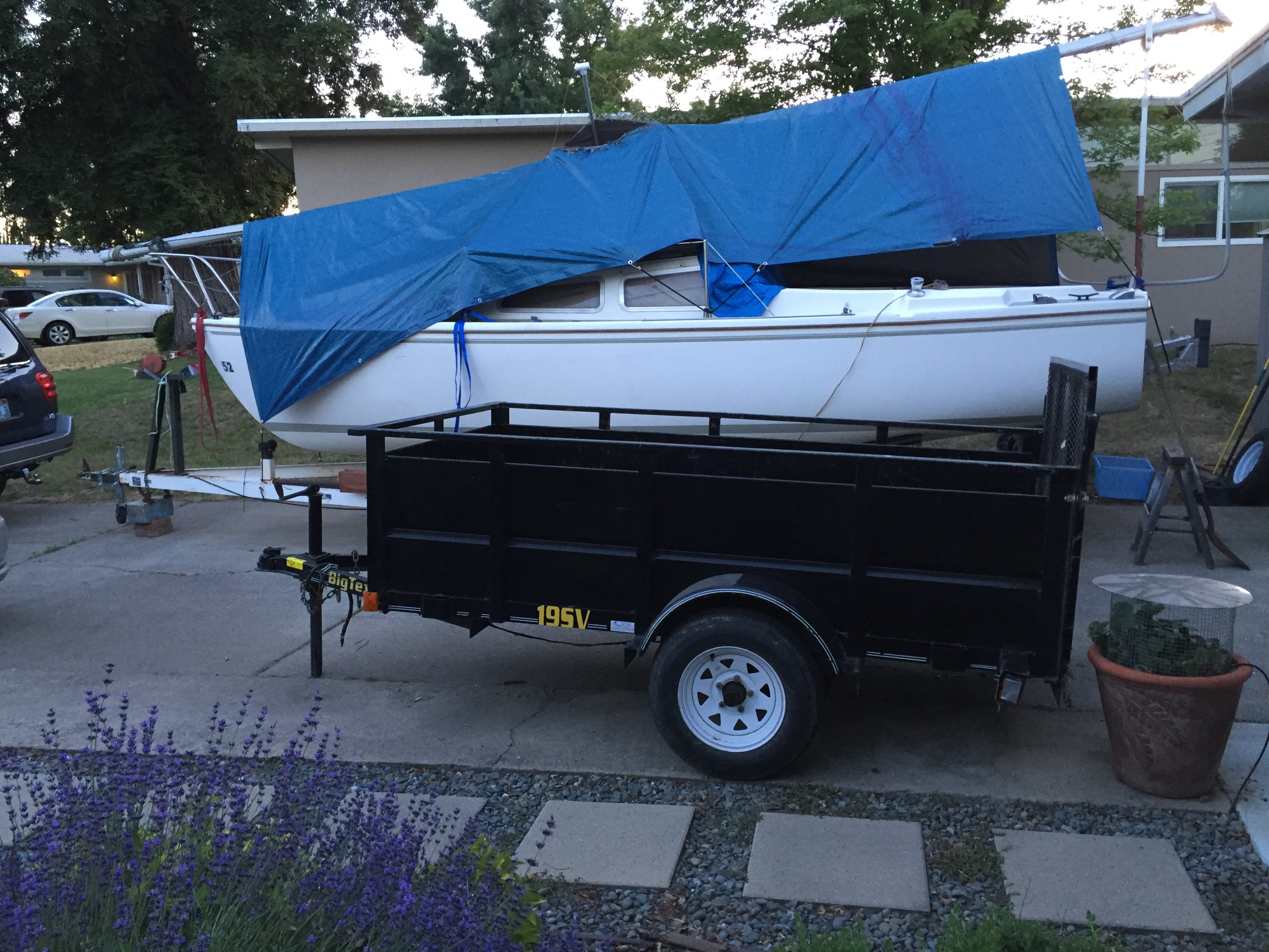

Your boat probably has multiple top side locations that are more than capable of putting a few inches of water into the bilge-- but the easy answer is your tarp sucks. I actually "shoveled" the tarp 3 times this year (one heavy duty version is plenty) and she's always high and dry. The version pictured below was two large tarps-- and the seam always allowed some water in. I found a continuous 25' long version that is a heavier grade and it lasts a full year plus a summer before it gets replaced in the fall with new. I think of them like sacrificial zincs-- the good tarp is cheap relative to the potential damage.
