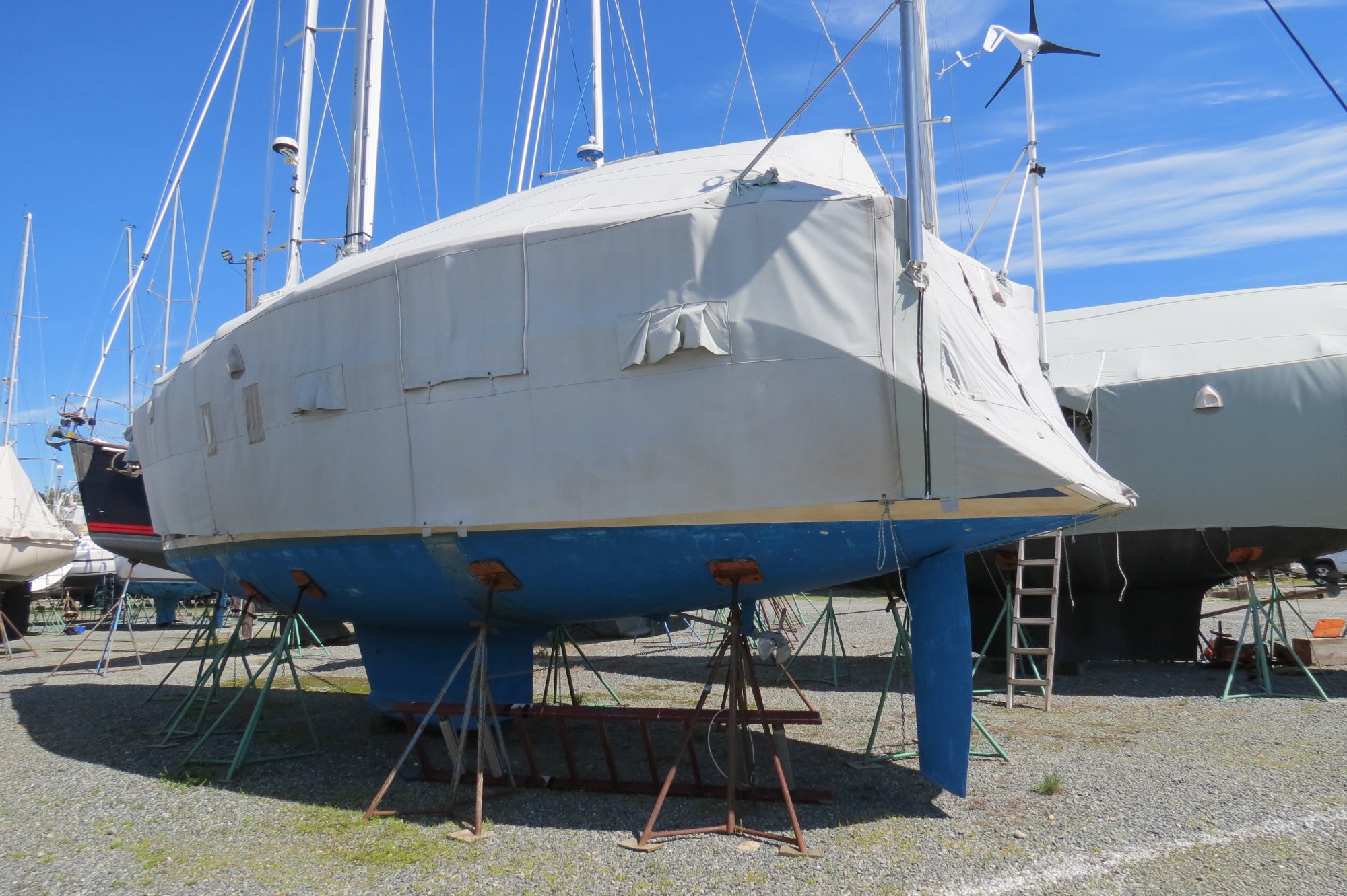

I am a huge fan of fitted full canvass covers. They fully protect the deck and the topsides and as an added bonus allow you work on the boat later in the fall and earlier in the spring. When others are bundled up and trying to work on their boats, you are in a t-shirt sitting comfortably under the cover.
Another advantage, because the boat is securely covered, it is possible to remove hatches, winches, hatch boards and other gear to take home to maintain. Last season, we removed the primary winches and rebuilt them comfortably in the garage while the hatches were sent off to have the lenses and gaskets replaced.
I've had covers from 2 different lofts. I much prefer Fairclough covers. For a boat your size, have them split the cover into two pieces with a zipper in the middle. Those suckers are heavy!

I have a Fairclough cover for my h40.5 and I am going on my 23rd year. I have re-stitched the cover and replaced some zippers myself. I have also added cutouts for a wind generator and a radar pole. Self-repair requires a heavy duty sewing machine like the SailRite Ultra. Whatever cover you get I would recommend having it made in THREE pieces, not two. The aft piece from the mast to the stern is very heavy. Two 70 year-old people can just barely manage it. This year I have bought a couple zippers and I will split my aft piece before installation.
I second the plan of a full cover for all of the advantages mentioned.

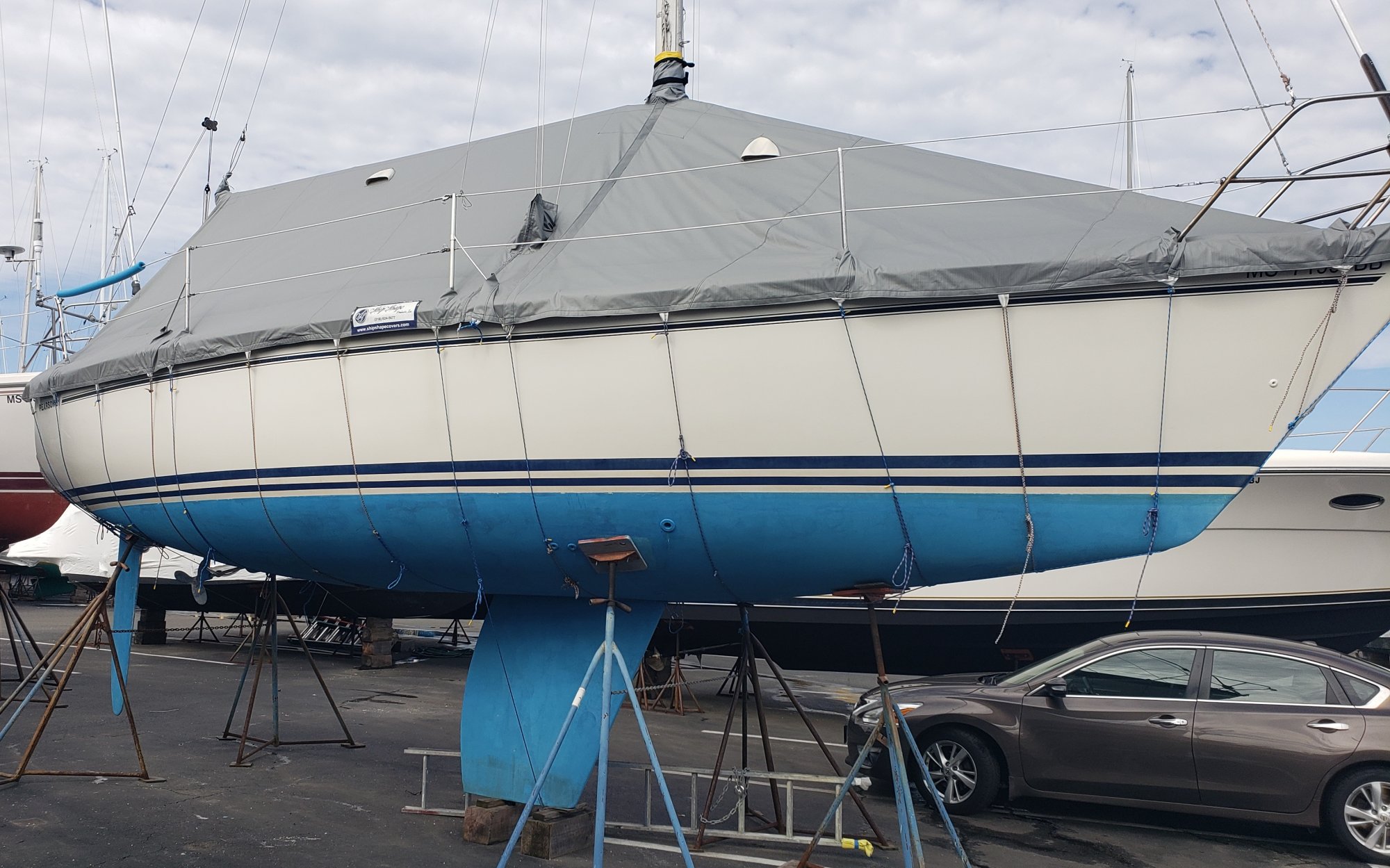

ShipShape offers a couple of fabrics as I recall - I got the standard plastic type material. It's reinforced and has some sort of coating. It has held up very well.
There is no frame with this system. You use the boom for the aft half of the boat. For the fore part, you attach a 2x6 board from the mast to the bow (I use pvc pipe instead of a 2x6. The ShipShape owner - a terrific guy to work with - was skeptical of pvc pipe, but it's worked well. I store the short lengths of pipe under the dock.) So the "frame" for my system is idiot proof. KISS is always good.

We bought a deck tent cover from ShipShape and I ditto the recommendation of that style cover and of buying from ShipShape. I am not sure what coated fabric they use, but it is lighter than canvas and I have no trouble installing and removing the two piece cover on our 31' by myself. IMHO, covering the topsides of the boat is wasted money, and obviously to be avoided if the boat is painted. We paid $2000 for our cover and after three seasons of use, it shows not wear at all.
We added some stanchion braces two years ago, and we able to send the aft cover section back to ShipShape who adjusted it as needed and returned it to us within two weeks for a minor charge. Very delightful people and easy to work with.
I consider this cover the best boat item purchase I've ever made, for two boat bucks its a steal.

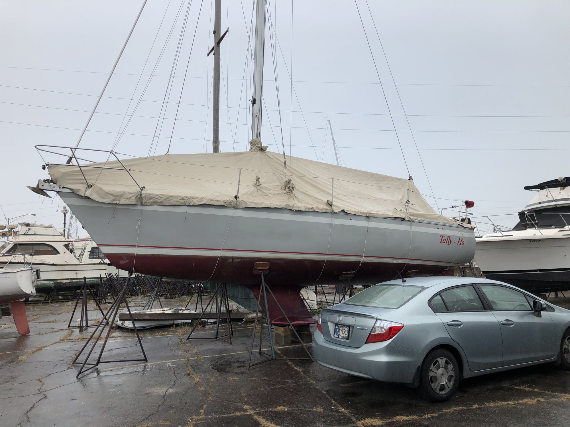

(canvas is way to heavy to manage). Thoughts?
first, a full cover, especially in the snowy climates is important to protect the boat...not only ice and snow, freeze and thaw, but also UV damage over the winter.
second, a canvas cover can be made in sections...so it is much more manageable. My cover is in 3 sections, that zip together with HD zippers. i can get each section up on deck easy enough, and then zip them together as I put them in place.
my cover uses the boom as a support, and a halyard to hold up the “tent“ in front of the mast. Works well and keeps rain, ice and snow off the deck.
importantly, this design does not go over the lifelines, so no frame is needed, and no damage tomthe stanchions results from a heavy snow load.
my first year, I used tarps, a wood frame...swore I would not do it again!
Good luck.
