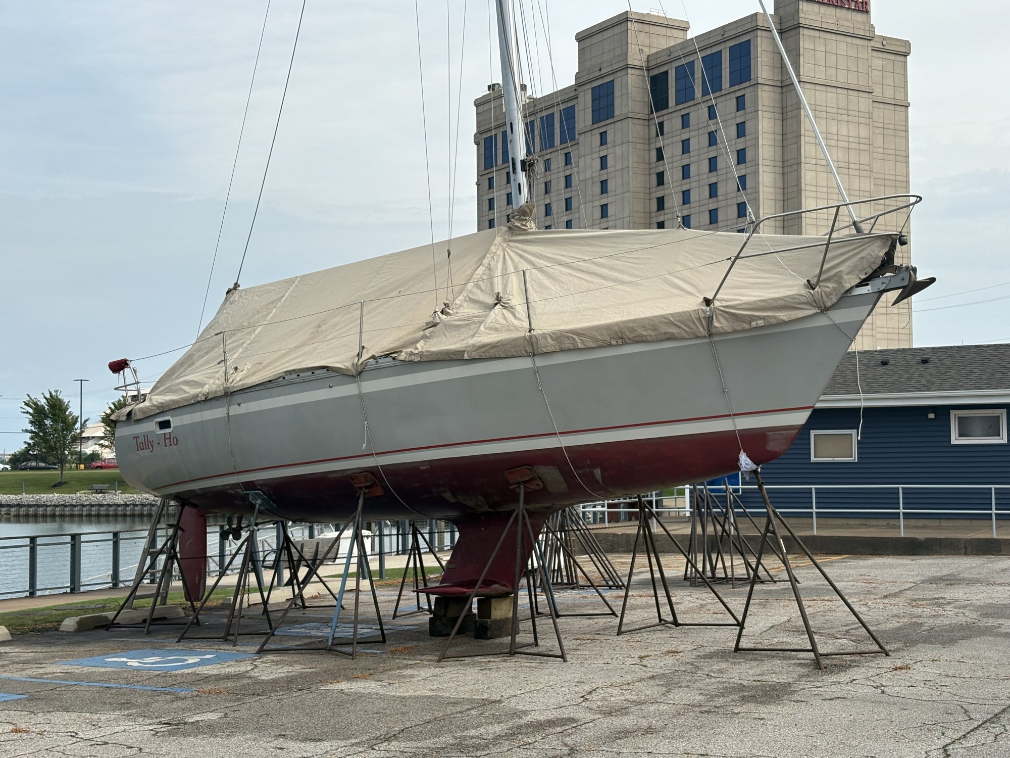

My cover uses the boom and a spinnaker halyard for support. You could come up with something to approximate the mast/boom (like a big, long sawhorse) and then add a support from the “mast” to the bow pulpit to support the front part of the cover. My cover has ties around each shroud, but only to get the cover around them and ”tie them shut”. No support on my from the shrouds.
If your cover is like mine, you will have several openings around the shrouds, topping lift, etc that will be open to the elements, but better than no cover at all.

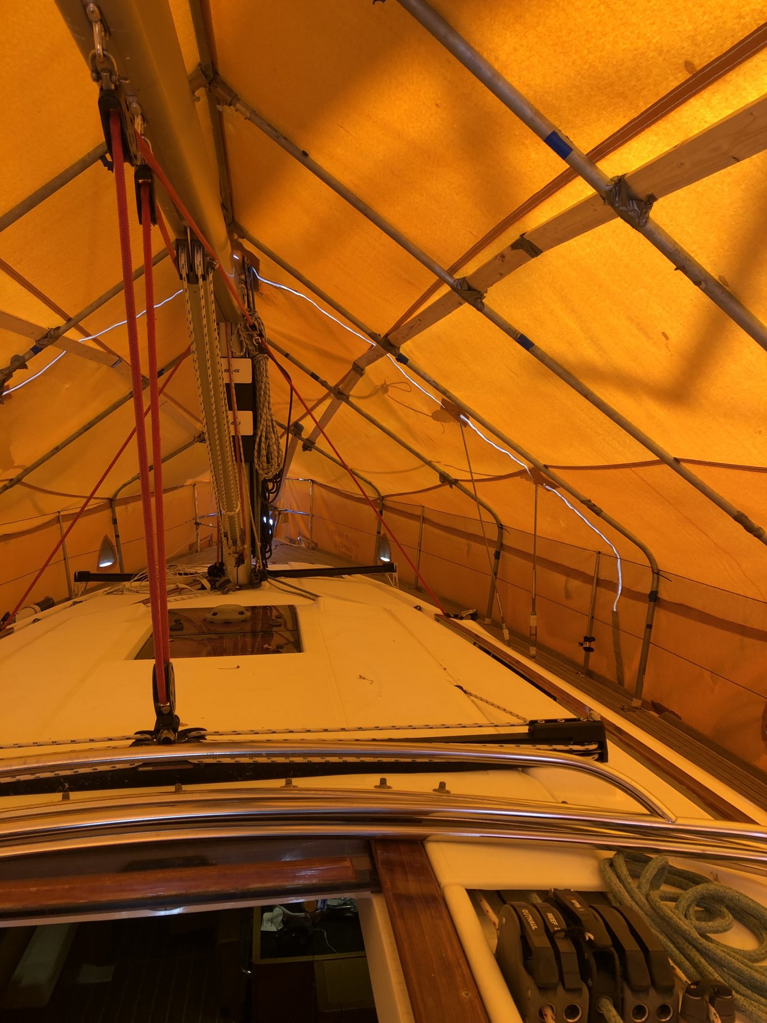

When I designed a cover for a customer, the mast was to be removed for moving the boat in the off season, so I planned the cover with the mast and made a fake mast with a 4x4 up to the height of the boom, mocked the boom with 2x4’s lying on the 4x4 and supported in the cockpit, you can and should use the topping lift or halyard to help support it. Hope this helps.
if you need more ideas, let me know, if you have pictures of th boat and cover it can help find solutions

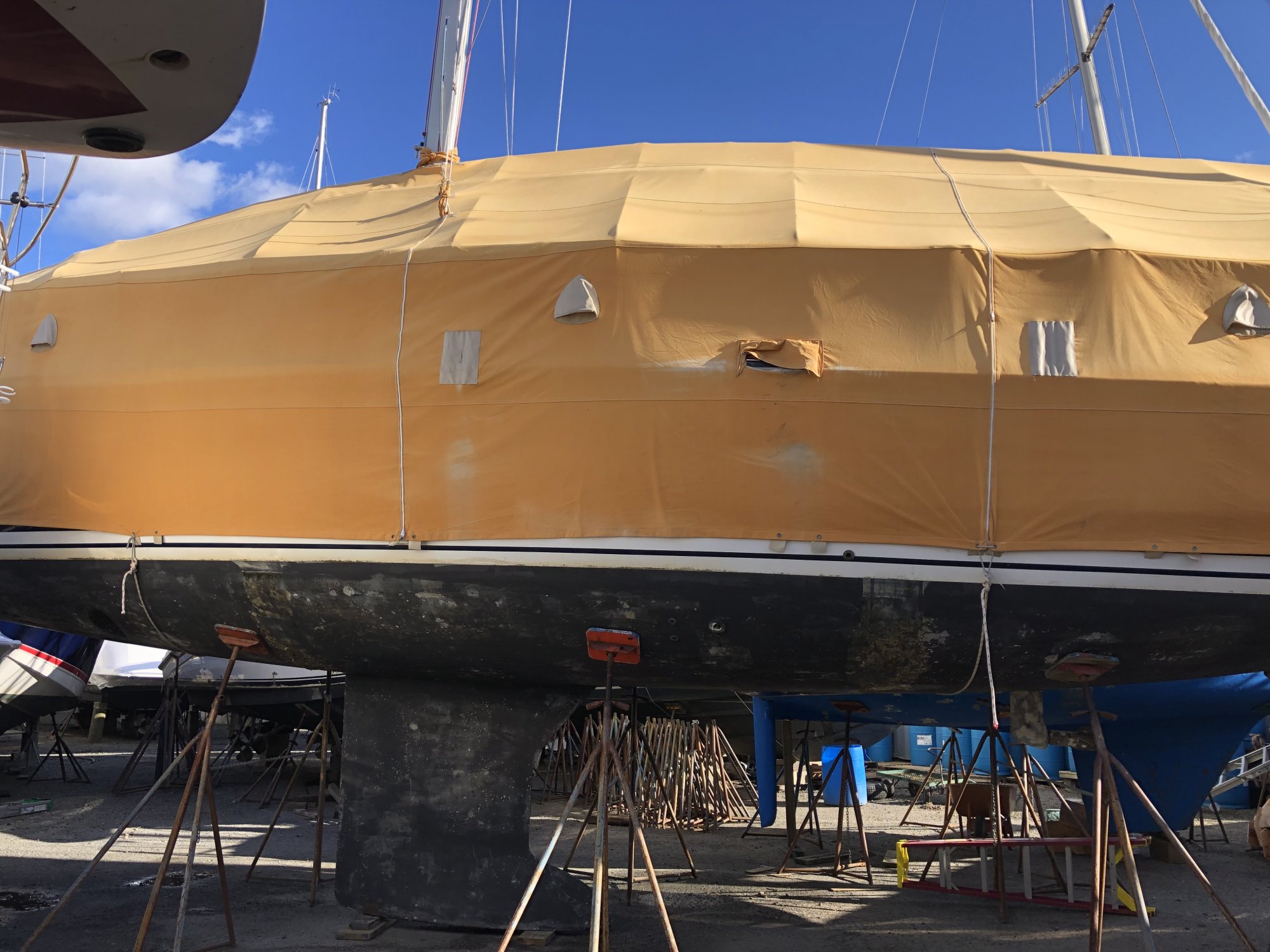

My boat came with a very nice cover and a complicated frame made of conduit. The cover was designed to allow the mast to be up or down. The frame hold up the cover. It must have been expensive to have made. It worked great the first year. The second year the boat was in the water. I was not able to run lines under the boat to hold the cover down and a large section got destroyed in a gale. I tried to get the section replaced but the company never responded to my calls or emails.
Since then I have had the boat shrinkwrapped when on land.
