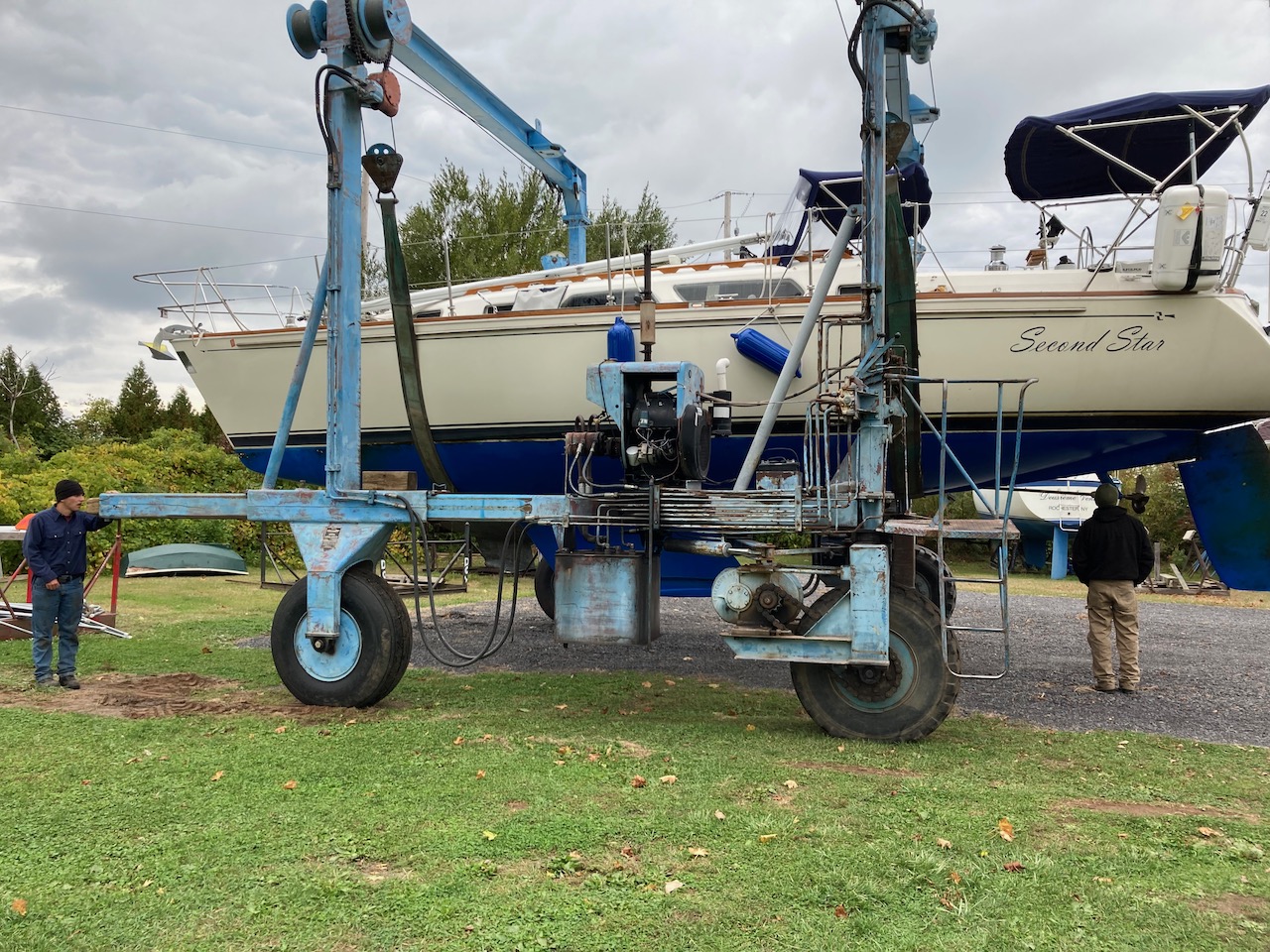

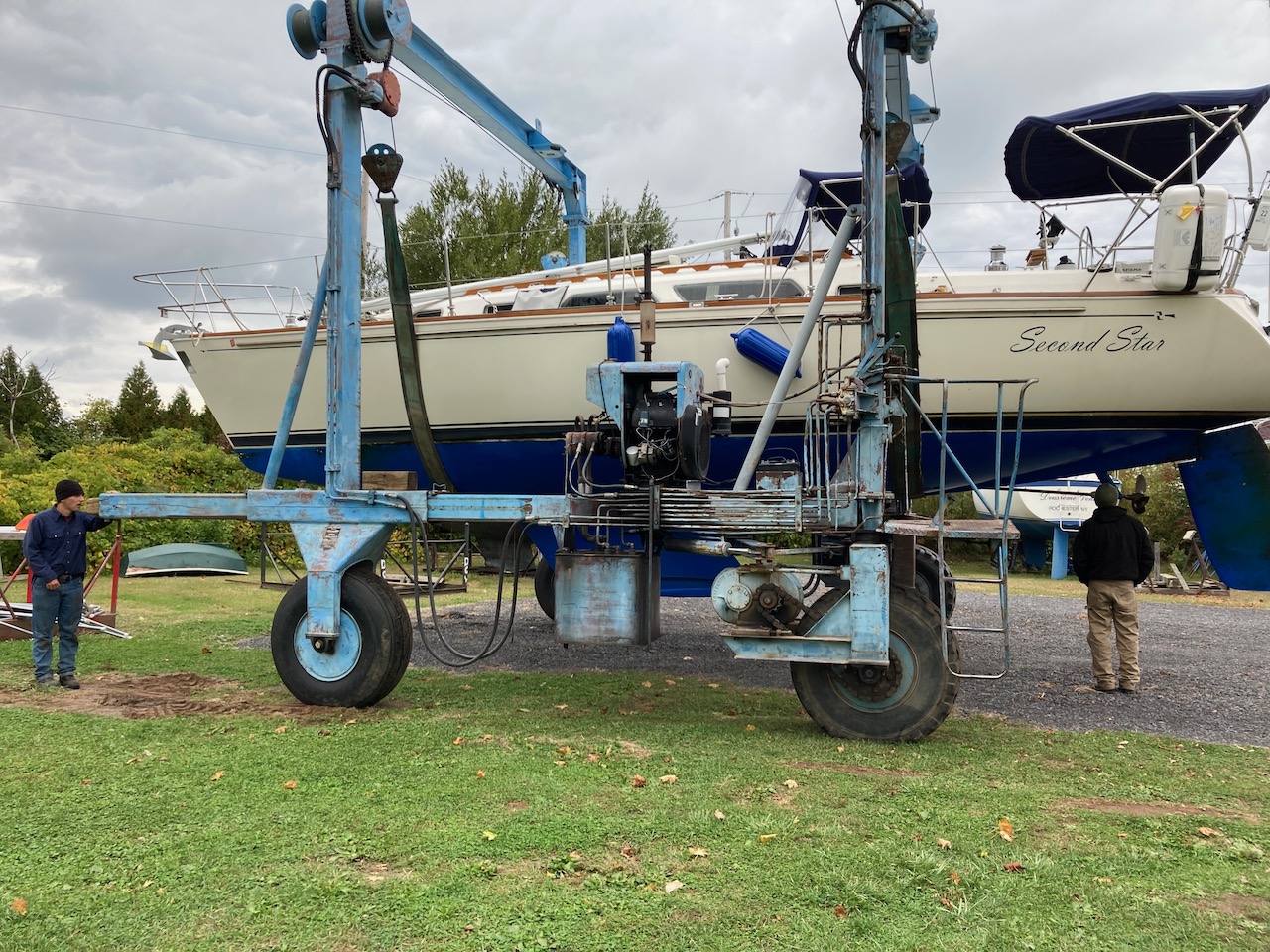

I'll never go back to VC-17. This year I used Petitt Hydrocoat Eco. It is copper free bottom paint that is about the most environmentally sound paints on the market. At the end of the season there were no zebra mussels, some alga on the top of the wing, and some slime. A hose, a soft brush, and about an hour had the bottom looking as pristine as a new coat of paint. The attached photo shows the bottom before it was washed. There is a lot of scum on the unpainted side of the waterline and on the port side of the rudder. (The port side faces south and is exposed to a lot of sun light.)
