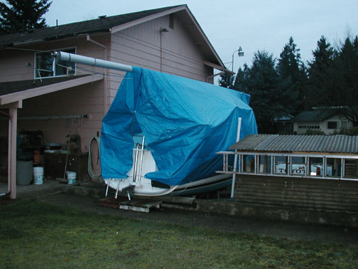

Here in the Northwest where it stays very wet all winter I use three tools to help keep the boat interior dry. 1. I cover the boat with a BIG blue tarp, (see photo) and leave the small side vents on the boat open. I have the mast supported horizontal with a 4x4 post at the mast shoe. This summer I hope to build a fiberglass roof off the side of the house. 2. I get something called "Air Dry" in bags, about 4 or 5 of them, from my local Homedepot hardware store. The big bags will last all winter. 3. I have a small electric heater set at minimum, on a timer to come on at night, that stays plugged in all the time so I don't have to remember it. It keeps the inside warm and dry. Oh, I also take all the cushions, sails, and other cloth materials and store them inside the house in our spare bedroom. That keeps them from mildewing. Also, makes for an interesting conversation piece when we have guests. Brigg
