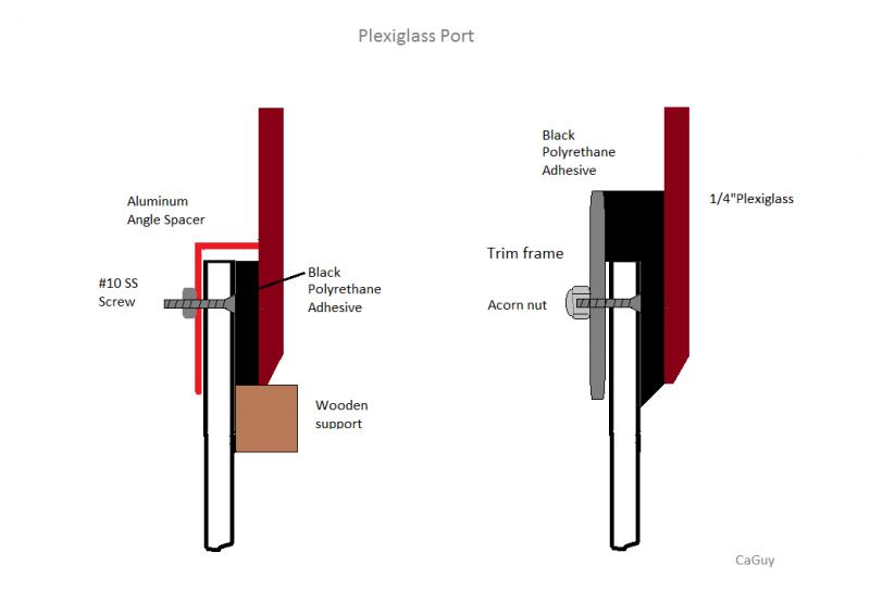

If using plastic, Lexan OR plexiglass, DO NOT countersink for screw heads. Sets up stress risers and WILL eventually split the plastic. Guaranteed.
Instead, over bore the plastic slightly larger than the screw shank, and use a PAN head screw.
The plastic (either kind) has a different expansion/contraction ratio than screws do. If the hole is the exact size, it will split when things heat up or get very cold.
I've done this kind of work- Building, rebuilding or repairing boats since the late 60's by the way.
