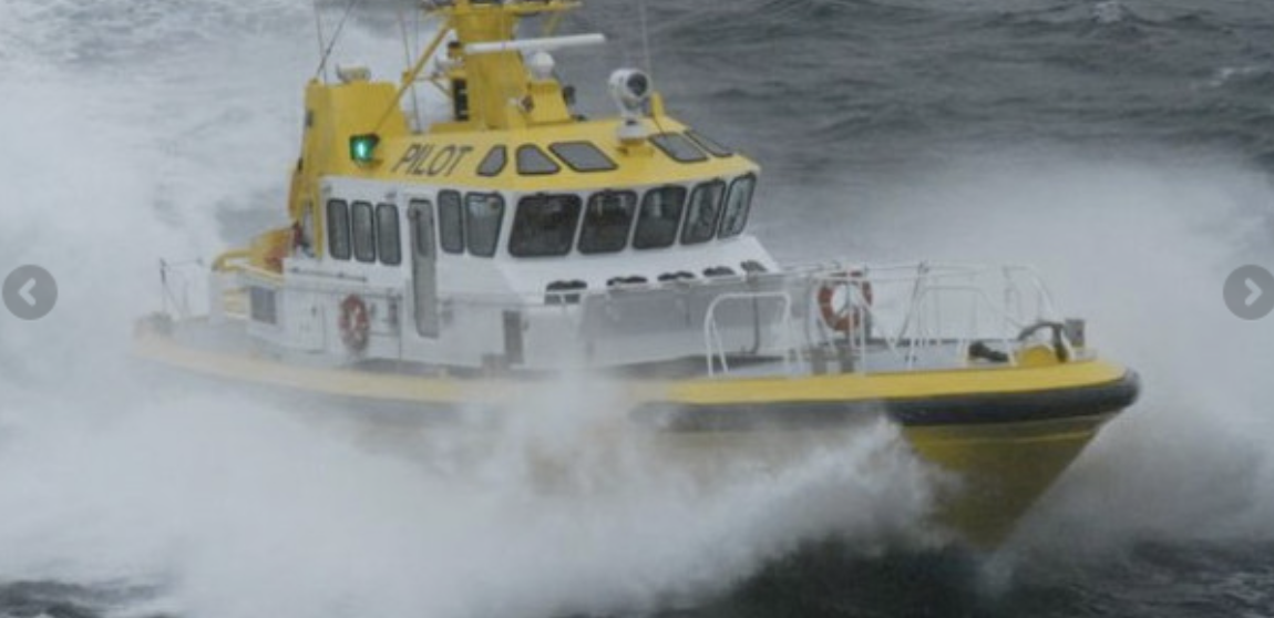

One of the big producers of marine glass is Gariboldi Glass in Vancouver. Besides yachts they do pilot boats and many CG patrol boats. Glass Supplier, Glass Contractor, Ceramic Frit
