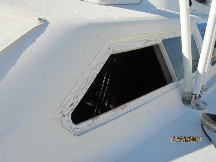

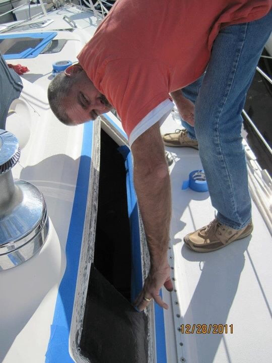

Hi Eian, be careful trying to just sealing the outer edge. I tried that with two different sealers. They only lasted 30 to 60 days! If you are going to spend the time I would do it right the first time! Pull it all the way out and reset it with the Dow 795! Then you won't be doing it again!

I am the poster child for the outer edge reseal short-term fix. And I guess I'd emphasize short-term. Dean is spot-on about it.
When I replaced my main windshield in 2000, I used Dow 795 and it's lasted. I've never taken the time to properly remove and rebed the side windows (largely due to my trepidation about chipping/cracking them while trying to get them out). I have many times scraped out as much of the sealant as possible and replaced it with the Dow 795. To nobody's surprise (including me), it leaks again within a period of time. Sometimes one year, sometimes two, MAYBE three. I look forward to doing the job right "one day."
