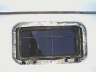

Before you start an NFM project be sure write me. Also see all that went before in the Photo Forum archives and the regular archives. The attached picture illustrates just one of many problems, the one where the portlights do not fill the hole. My H37C has ten NFMs, six are 7x15 and four are 5x12. The one in the cockpit for the q-berth still needs replaced. When the Cherubinis went with the larger portlights(like 36") I don't think they were the opening type. So that is a different problem, sealing a fixed portlight. Ed s/v Ladylove h37skipper@aol.com
