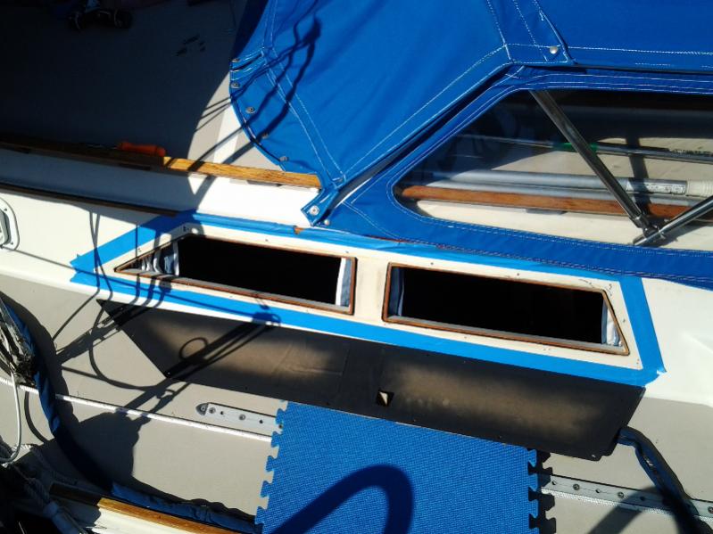

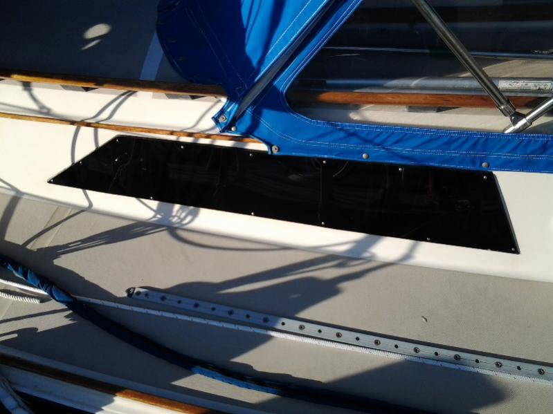

Do a search here...I posted pics. 3m vhb tape and dow 795 sealant Trust me....you do not want to drill them
I completely agree. No need for screws unless you must use them while the adhesive sets and then fill them but any other method to hold it in place is much better.
