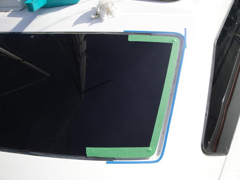

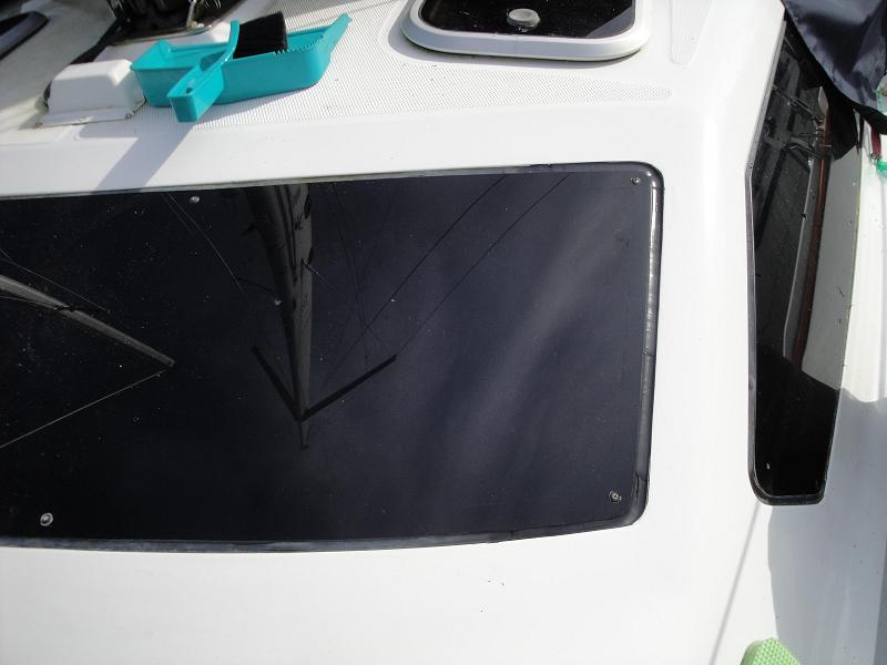

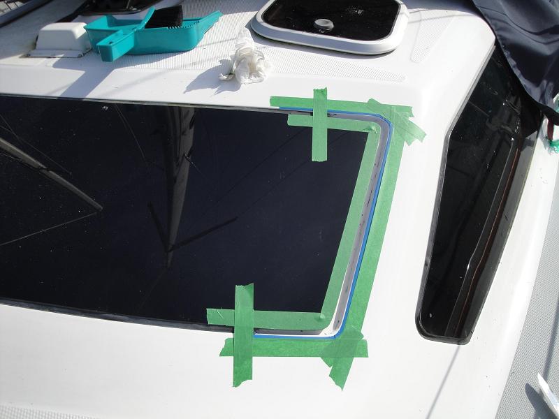

Here's a sequence of repairs for one section of the front hatchlight after I suffered a microscopic leak for a couple of years.
Here the problem section has been cleaned out using an exacto knife and coarse (80) sandpaper. The blue masking tape is highly flexible.
Automotive masking tape.
The masking tape is fully masked (just because I hate cleanup).

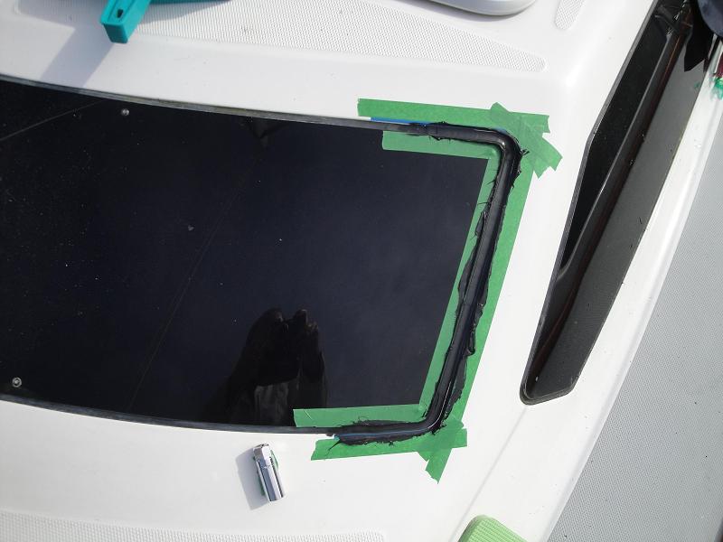

DC 795 is pumped in as deep as possible and smoothed with a 1" socket (or something equally round).
The finished product.

Did you use 3M 4200 caulk?
Used DC (Dow Corning) 795 silicone. Seems to be the industry standard for most boat mfg. The original still looks like the new stuff. The big problem with this front hatchlight is its width. Just too wide and sets up a large differential thermal expansion when it heats up (and probably when it gets cold as well).

Ralph, thanks for your reply. Your solution looks like a perfect fix. The sealant is also good fit. Another 'board' suggested removing the entire window and rebedding it......I know I don't want to go that route.

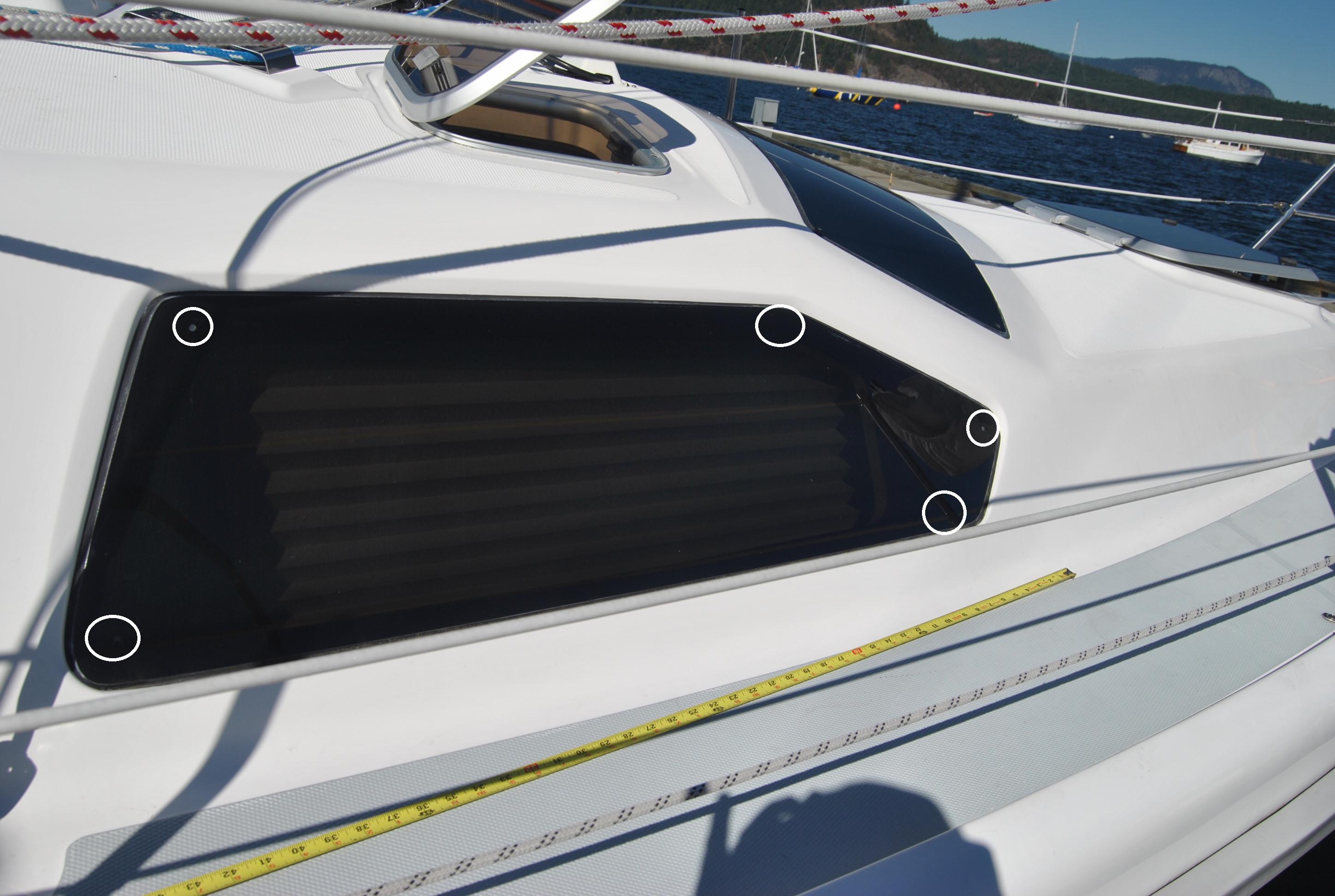

Ralph
Great looking job! Is your window screwed into place? Can't help notice the screw heads or dimples equally spaced. I might be wrong but I don't think the Bene's are fastened. It is one long window that must have some curvature in it. I'm not sure how it would be held in place for curing.
Dow 795 or GE Ultra Glaze are both structural adhesives used to hold their windows in place on all those high rise building we walk by. Got to be pretty good stuff! GE Ultra Glaze is what Bomar recommended for their hatch repair. 795 is more readily available and is equivalent. That's what I would use.
Jan 4, 2006
7,870
Yes, all windows were originally screwed while the sealant set and then removed. Holes then filled with 795 and are invisible unless you're close up.
They may have left the screw in the forward curved hatchlight to ensure the 795 had several months to cure.

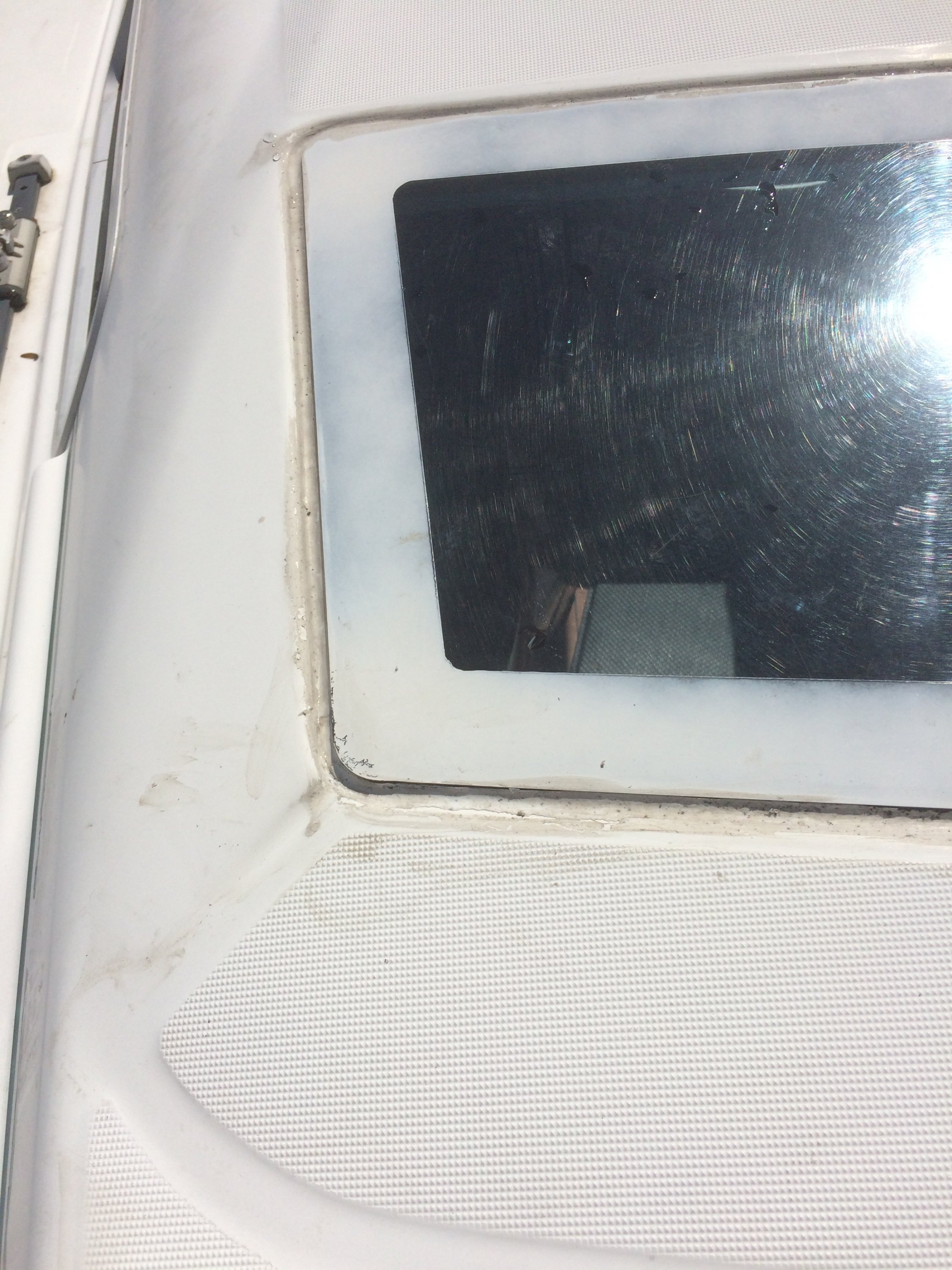

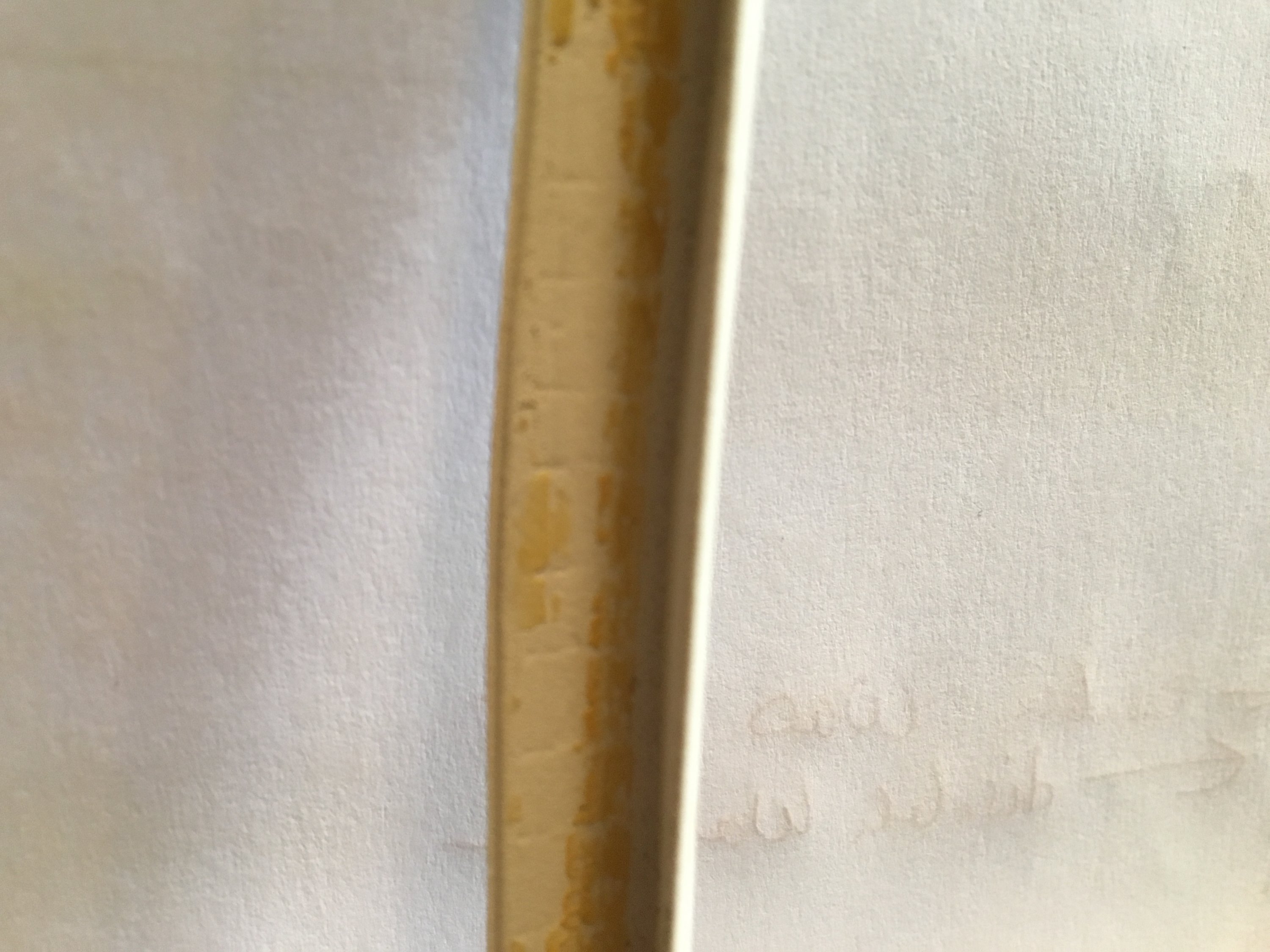

Interesting as my 323 had the very same problem and thanks to this blog we also used Dow 795. The hardest part was cleaning the old stuff out. Instead of using a small socket my buddy Jim suggested using a plastic spoon to finish it off. It worked like a charm and just throw it out eliminating the cleaning. So now that that was done and successful I might add, there is the need to replace the finish trim around window inside. The original material is brittle and looking hideous. I'm not sure where to get it or if there's a suitable replacement. Any ideas?? I've included two pictures of the existing stuff that's short of 90 and 1/2" on each side.
Thanks,
