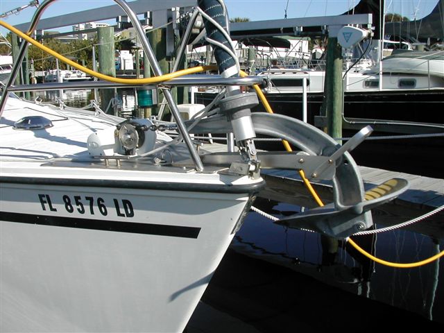

I installed a Horizon 600 electric windlass on my Vision 32 by making a stainless bow plate covering about half the anchor locker and fitting around existing stantions. A roller was welded to it and the windlass bolted on it. The Locker cover was cut and rebuilt to fit. Works very well. I can supply photos and details if you are interested.

Noel, Your windlass installation is really cool. I would like to see more pictures and details. Thanks, Jim
