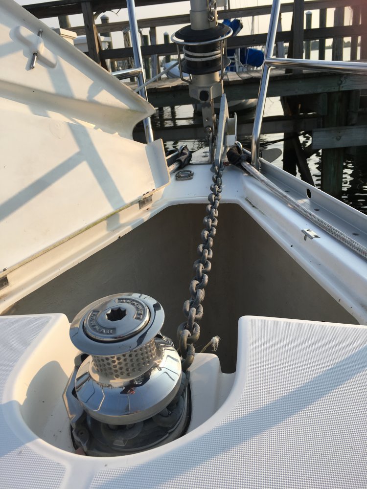

I have a 311 and just finished an install of a Maxwell windlass, their HRC FF 8 model. The 311 has an inset anchor locker and a nice spot to install one that can be hidden when you close the locker door.

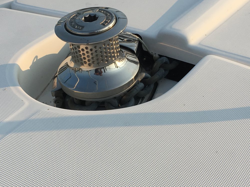

Beneteau used a Lewmar concept 1 windlass on the Beneteau 331 and 343 for sure. Probably used the same one on the 323. Unfortunately, the windlass is no longer available. I installed a Lewmar V3 windlass with gypsy & drum that accommodates a 3/8" chain & 5/8" nylon rode a few years ago. You can probably get by with the V2 windlass that handles 5/16' chain and 9/16" rode. The gelcoat surface on my boat actually had marks scribed in the anchor well to guide the drill alignment for cutting the hole for the windlass. If you attempt the installation yourself, you've got to measure everything repeatedly to ensure that the windlass is going to fit. I sweat bullets when cutting that hole in the anchor well. Everything has to line up; not much room for error. Its a fairly expensive project, even when doing it yourself, because of the cost of the windlass and approximately $500-600 for marine grade cable, lugs, and a hydraulic or heavy duty mechanical crimper to make up the cables.

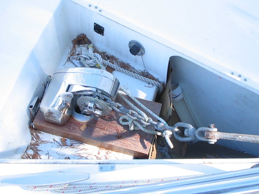

I added a Lewmar 1000 to my new B323 2006. a pic of my original locker. Later on I moved it forward, cut the block shorter to improve the chain fall. At the time, I had 177 feet of chain- now 142. I have an installation document that apparently I need to reformat to download it.
OOPS- I see I poosted my document under Owner Mods/323. It includes a pic of the forward position. To answer Jsailem, it is 5/4 teak There is a local wood supplier- the kind that cuts trees down to boards. This piece was in the "scrap" wook bin.
23,841
Very Nice Ron. Is that a piece of Treck decking you used as a base?

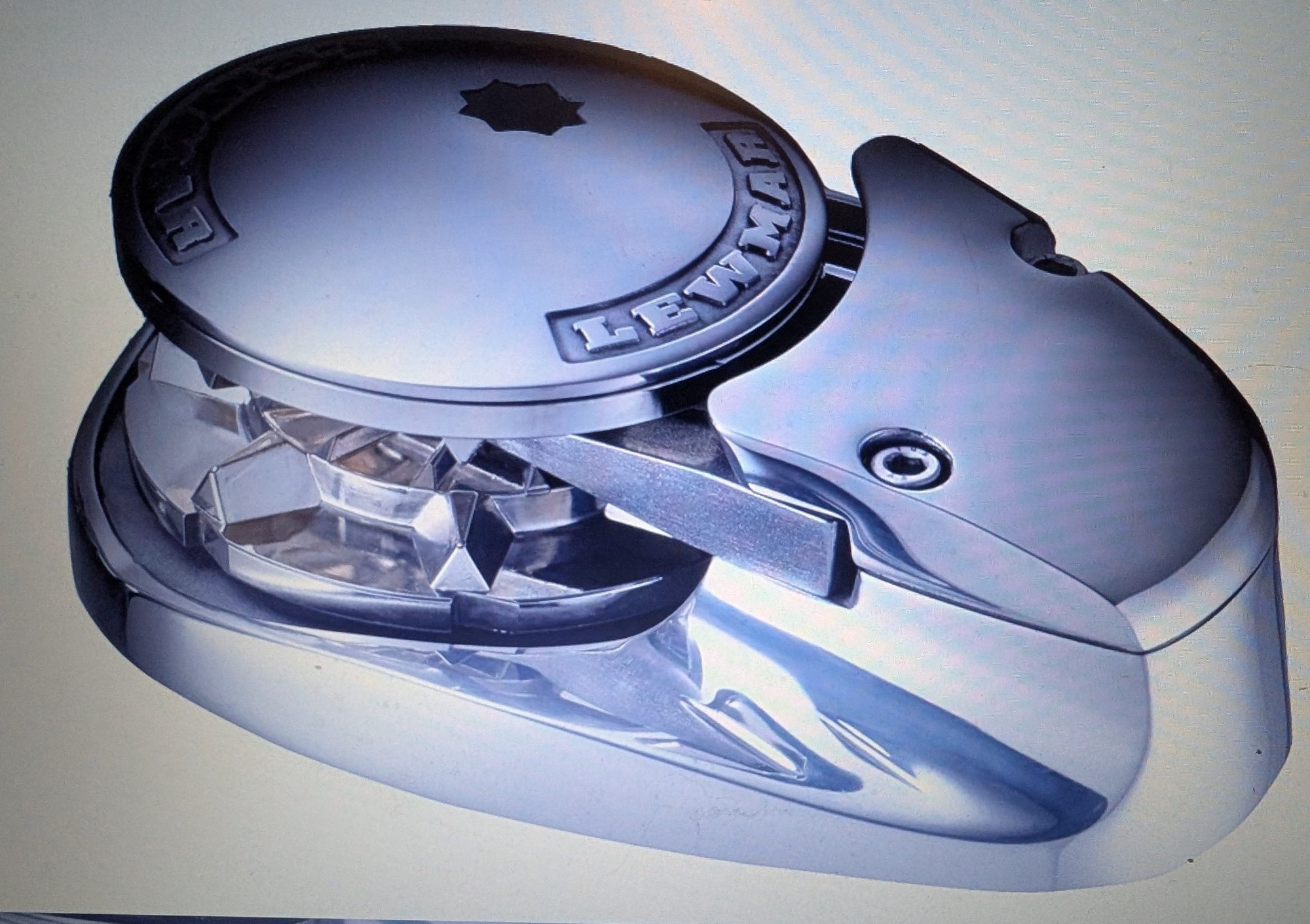

Quite a while ago, the boat is down at the shore, paperwork also. I'm pretty sure it was a Lewmar windlass. Looks very similar to the attached file. Included a hand held control as well as the correct amount and length of wire, connectors, breaker, complete package. Lazy way of doing it, I probably saved about half on that option price.
