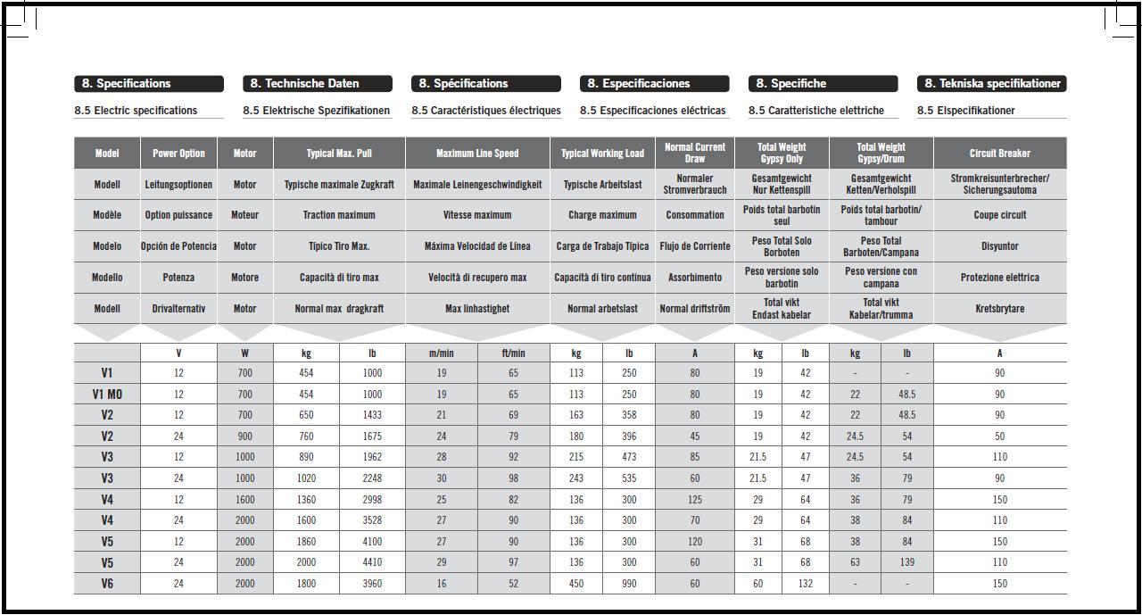

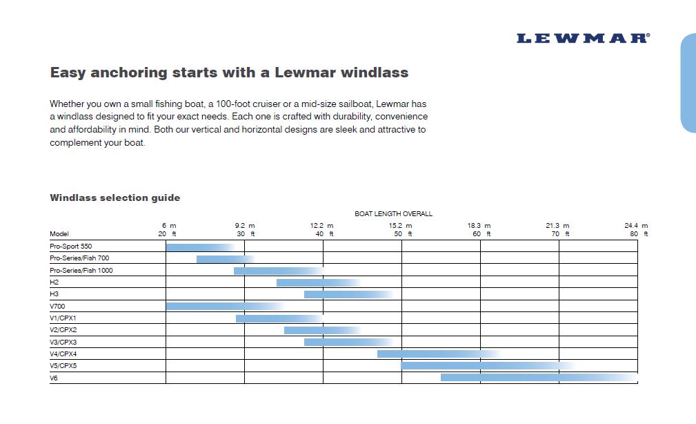

I can't speak to the VX1 as I'm too lazy to look up the specs but the V700 is definitely undersized for your boat:
And that's only step one of the preliminary guesstimate. The next step is to calculate the weight of your tackle and using a factor of safety of 4, see if the working load of that windlass is sufficient. If not, increase the size until it does work. An undersized windlass is worse than no windlass at all.
Given the cost and work involved in the installation of one of these things, download a Lewmar windlass manual and study the specs of your selection "intimately" before doing anything.

Thanks for the responses guys! And thanks for including the Lewmar chart Ralph. I've actually studied it and the documents on the Lewmar site. Since my boat is 35' 6" the V1 should work. I'm still trying to find out if it will properly fit in the anchor locker. Also how to mount an under-floor autopilot.

V1 is only slightly better than the v700 according to the chart. The bar on the chart is already starting to fade out, putting it out towards it's limits. A V2 would be a better choice, and probably not that much more cash.

Getting closer .................... now read, read, and re-read the specs:
And then use the Windlass Selection Guide to include the factor of safety (page 3). And finally, the ultimate question ! ! ! ! ! ....................... will the V2 handle your rode and anchor ? ? ? ?
