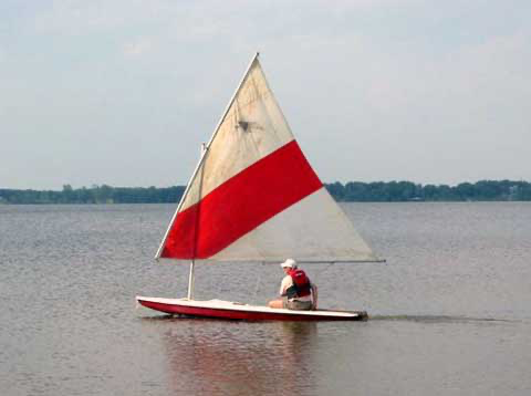

Is this your boat.
23,794
If so the spelling is Windflite. It is a AMF built boat.

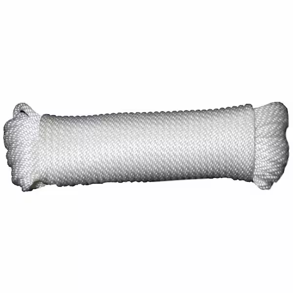

the lines are in such bad shape I am having a hard time finding what I need to replace. If anyone knows the standard rigging dimensions for lines I would greatly appreciate the information.
If cost is a challenge, buy some low cost 3/16 to 1/4" nylon line at a box store and cut lengths
Use them as a template.
  • To raise the sail with a halyard,you'll need a length that is two times the length of the mast plus 3 feet.
  • For a mainheet, set the sail boom out to 90º from the boat. Measure the distance from the end of the boom to where you will be sitting on the opposite side of the boat from the boom. Then add 5 feet.
These are rough get you started lengths. They should provide you with more than enough line for the two lines. You can then test the rig and trim the lines if you feel the need.
Nylon is a stretchy line. After you settle on the exact lengths you may decide to spend a bit more for Dacron (polyester) double braid. \
3/16 in. x 100 ft. Solid Braid Nylon Rope Hank
at HomeDepot $10
