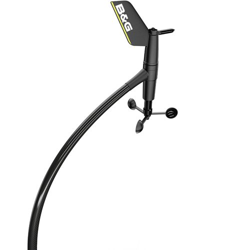

The first time I saw that contraption the engineer in me said WAY too much moving/rotating mass. The perverse part of problems like that is any attempt to fix it usually results in making the original problem worse.
The world's best marine wind sensor (B&G WS710) looks like this. All other serious ones do as well. For a reason.
