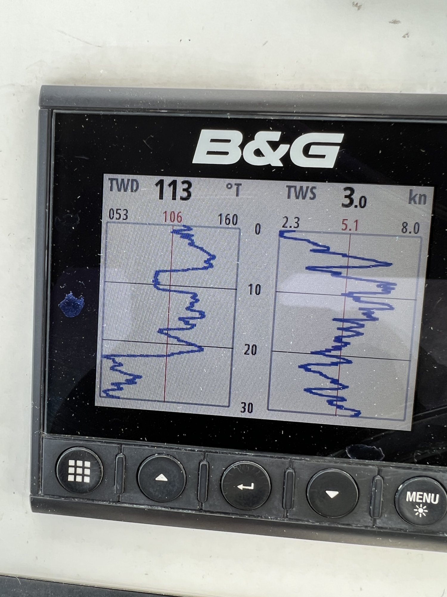

I believe I found the reason for the drifting TWD: A fouled paddlewheel on the triducer (DST810). Here is why:
I motored out of the marina. At first, the STW was zero. After about 10 minutes the STW was showing about the same as the SOG. The main difference as I left the channel was due to current. Once clear of that effect (the current down to 0.3 kts) I began making tacks while still motoring. The TWD plot varied some, as appropriate for the wind conditions, and no large swings with the tacks.
The wind was light, 3 to 6 kts. I put up the sails and shut off the motor. Before I made the first tack the STW went to zero; probably not enough water flow to overcome the resistance. With these winds, the boat was moving at about 2 kts. So I selected the instruments to use SOG for STW to calculate TWD. Now when I tacked, the TWD would swing with my heading. From a port tack, tack to a starboard tack, and the TWD would shift significantly to port. And the other way around.
I also noticed that the instruments were saying the current was now nearly 2 kts, boat speed. What I'm thinking is the AC42 autopilot (which calculates current, TWD, and other terms) uses STW to calculate current. If STW is zero, then the boat is drifting with the current. That then throws off the calculation of TWD.
If you look at the attached image, before the 10 hack, the boat was on a port tack. I tacked onto starboard and the wind shifted the same way. After a few minutes I tacked onto port and again the wind shifted the same way.
My problems with my paddlewheel are due to too much anti-fouling. I should have only applied it to the flat section and the sides. No more on the paddlewheel.
