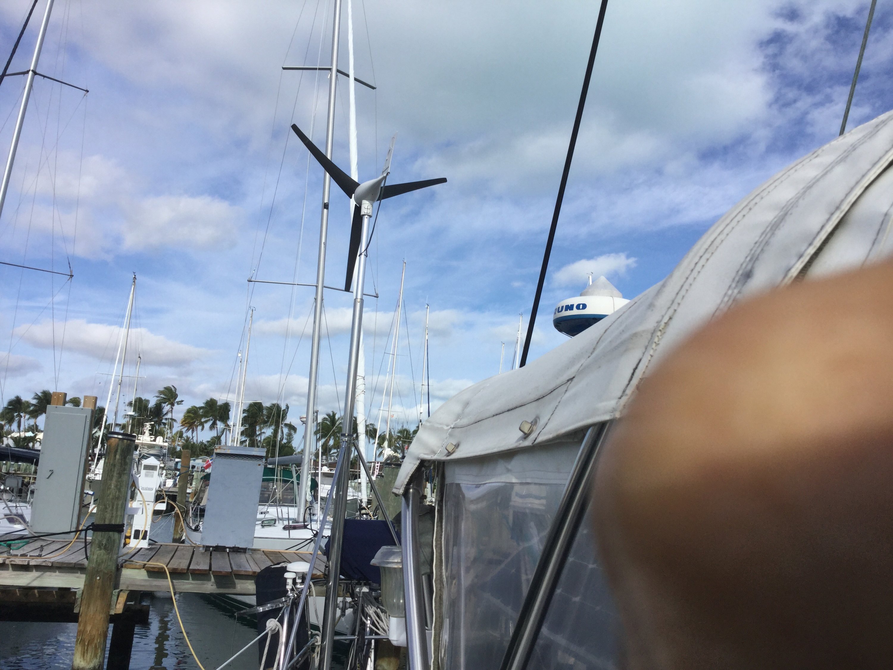

Hi cruising pals,
Do the blades on a wind generator need replacement on a regular basis? We have the original blades, black, and I was wondering when they would expire. Are the blue blades that much better?

It looks like you have the Air-X 400, just like mine. Air-X recommends 5 year replacement schedule for an unknown reason.
I replaced my blades about 7 years- just because. I promptly had one new blade break and after I returned them the company said it was due to a bird strike- not covered by warrantee.
Well, I did not find a dead bird, feathers, blood, or any other evidence of a bird strike, but the bottom line was I had to buy another set of blades. Left a bad taste in my mouth.
If I ever buy another set, it won't be from Air-X. There are at least two other suppliers. One is half the cost of Air-X and the other is a European supplier who claims that his blade are virtually silent. But they cost 3X the price of Air-X. I think they are the blue ones to which you refer.
I don't know if the blades degrade due to UV, or why they need replacement. Maybe someone else has the answer.

Any composite material will eventually fall victim to UV. You should be able to give them a visual inspection, flex them and listen for the sounds of cracking.
The bird strike excuse is just bad business :kick:, even if they really thought that was true.

my blue blades on my air breeze are around 4 years old. i see no signs of deterioration. the blue blades are quieter than the old stock blades but not extremely different. vibration into the hull is still there. i have changed bearings twice on my unit in 6 years, that helped more than a blade change

So there isn’t a nondestructive test for determining if the blades are soon to be retired? I just wonder how close in equal weight these blades are since balance is so important.
