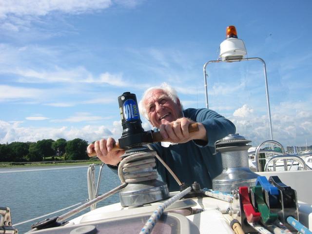

Well having now received my Winchrite I can report the following:
1. My slender partner winched me up the mast without problem. This is a big plus for elderly cruising couples.
2. I then tried it out on one of my crew who weighs 120 Kg without problem.
3. We then went on our weekly round the cans race and raised the main and did some final trimming using the weakest crew memberand finally neatly furled the headsail in 20 knots without problem.
Its an excellent bit of kit and sits flat on the deck without moving even when well heeled. Needless to say I have no connection with the company.

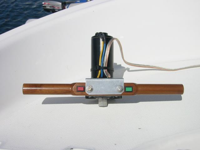

People might be interested in my recent posting on the UK Legend Owners web site.
http://forum.legendowners.com/index.php?topic=958.0

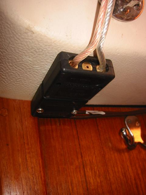

Faced with the same winching problem for both jib trimming and mainsail raising I did the simple arithmetic and realised that no battery which I would regard as light enough to be truly portable could contain enough energy for 20 tacks or one haul of a man to the masthead so I opted for house battery power. Remember that even lithium ion batteries do not like being discharged more than 50% and they really are pricey!
The photos show my home built device and the text describes the work done.
BobM
