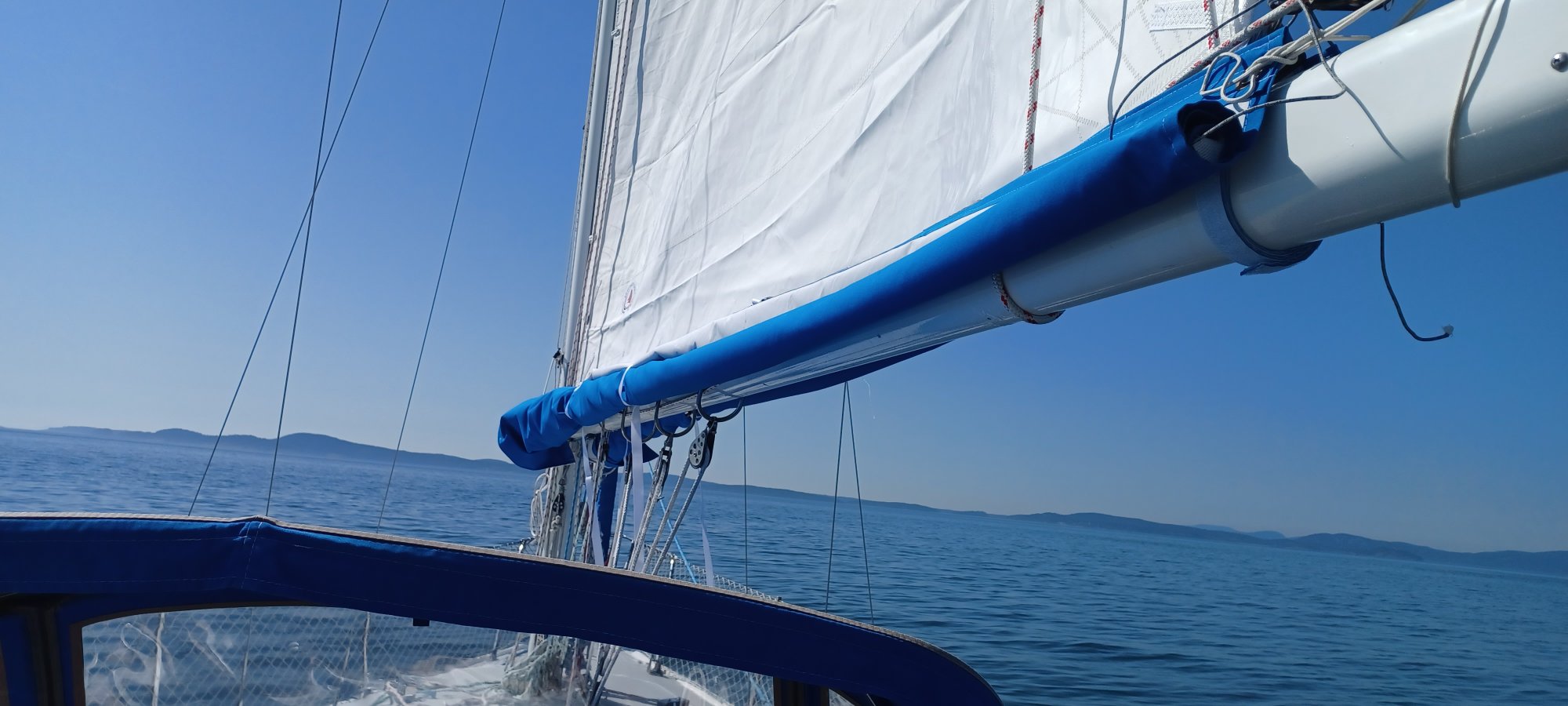

I have a stack pac that we designed that allows the jacklines to be dropped and the cloth to be rolled alongside the boom so there is nothing to snag the sail as it goes up.
Could you please send me more pictures of the sail pack, designing mine at the moment, looking for ideas
Apr 5, 2009
3,211
Could you please send me more pictures of the sail pack, designing mine at the moment, looking for ideas?
Here is a thread that Ward started on the pack that he built based on the design and drawings I sent him on mine. Post #8 shows the Pap-Pac rolled up alongside the boom with the jack lines in the stowed position. Post #9 shows a bunch of photos showing the details of how it works.
