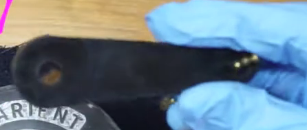

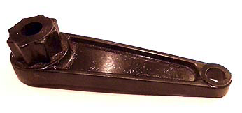

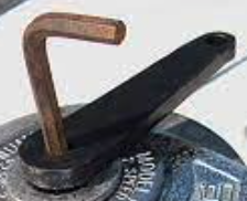

Wow...great information. I do remember a boat owner next to us mentioning "flying" winch parts. I did contact Hutton-Arco who gave me a quick reply. I was told to try cleaning the winches first and if I then needed parts to contact them with pics. They mentioned a tool they called an "accessory handle" or a handle with a hole in it. Not sure what one is! Any ideas? I'll keep investigating;)
May 17, 2004
5,754
Probably a small plastic winch handle shaped device with a hole in the middle of the socket. The handle lets you keep the winch from turning while you loosen and tighten the screw in the middle of the hub. If you don’t have one you can try just holding the winch in place when loosening the screw, or maybe holding it with a rubber oil filter style wrench.

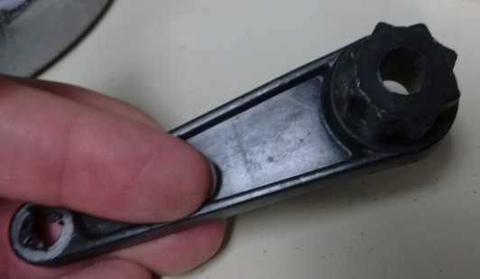

My Barlows ST winches have 2 holes in the cap that hold the winch together…my “tool” for removing the cap is a small piece of wood stock (like 4” of 1x2), and two screws drilled through the wood at a distance equal to the space between the 2 holes. Stick the screw tips into the holes and twist the cap off.
