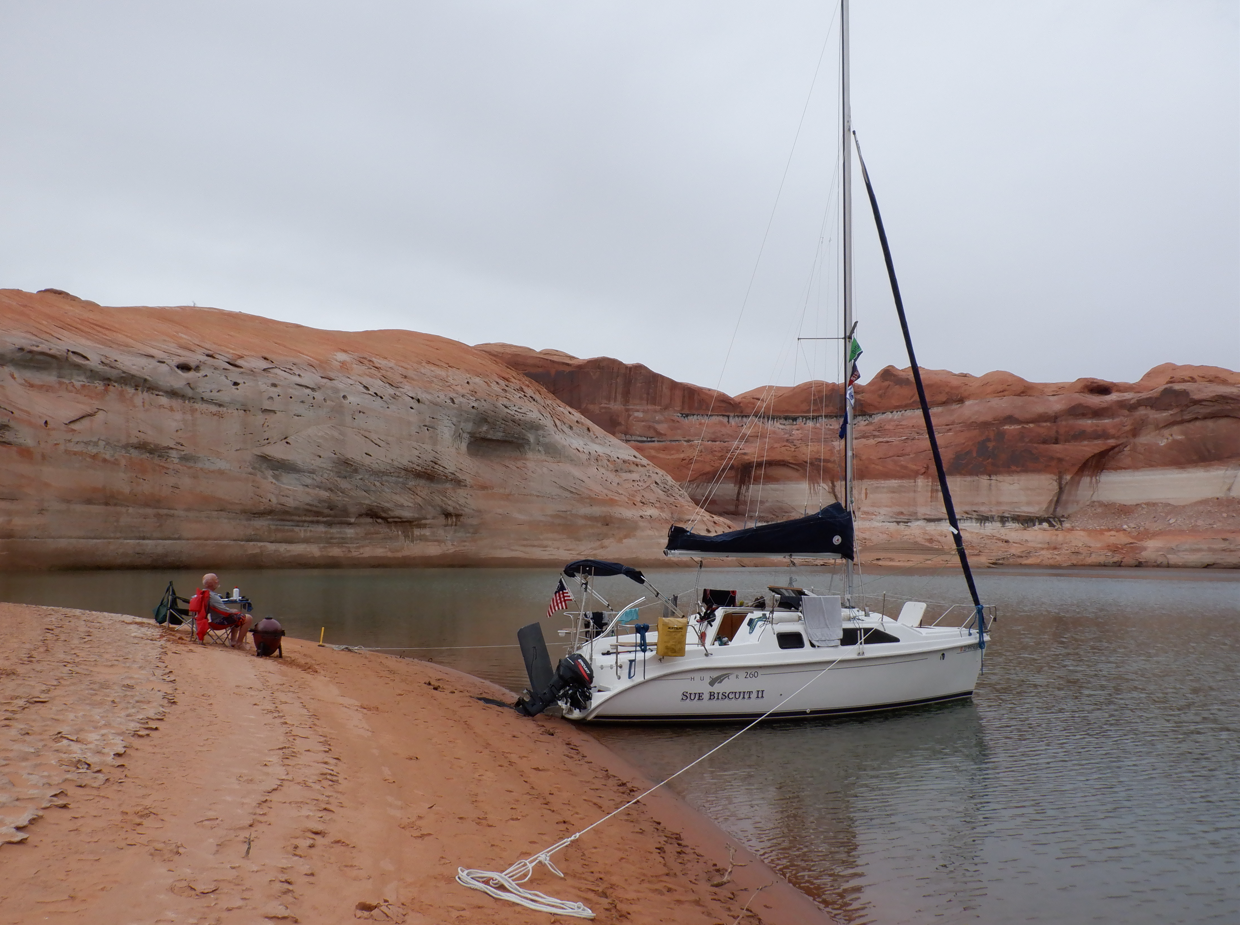

Best Sue B II recent investment has been a tide track and stack pack. Makes singlehanded hoists quick and the weight of the main allows complete depowering in about 1.5 seconds. Zip up the pack and good to go - main is stowed. No flake & ties bouncing on the cabin top. A very pleasant change.
Escalante River (Lake Powell) this spring (there are some good thinks about water ballast and drawing 18"). Had not yet added battens in the stacker.

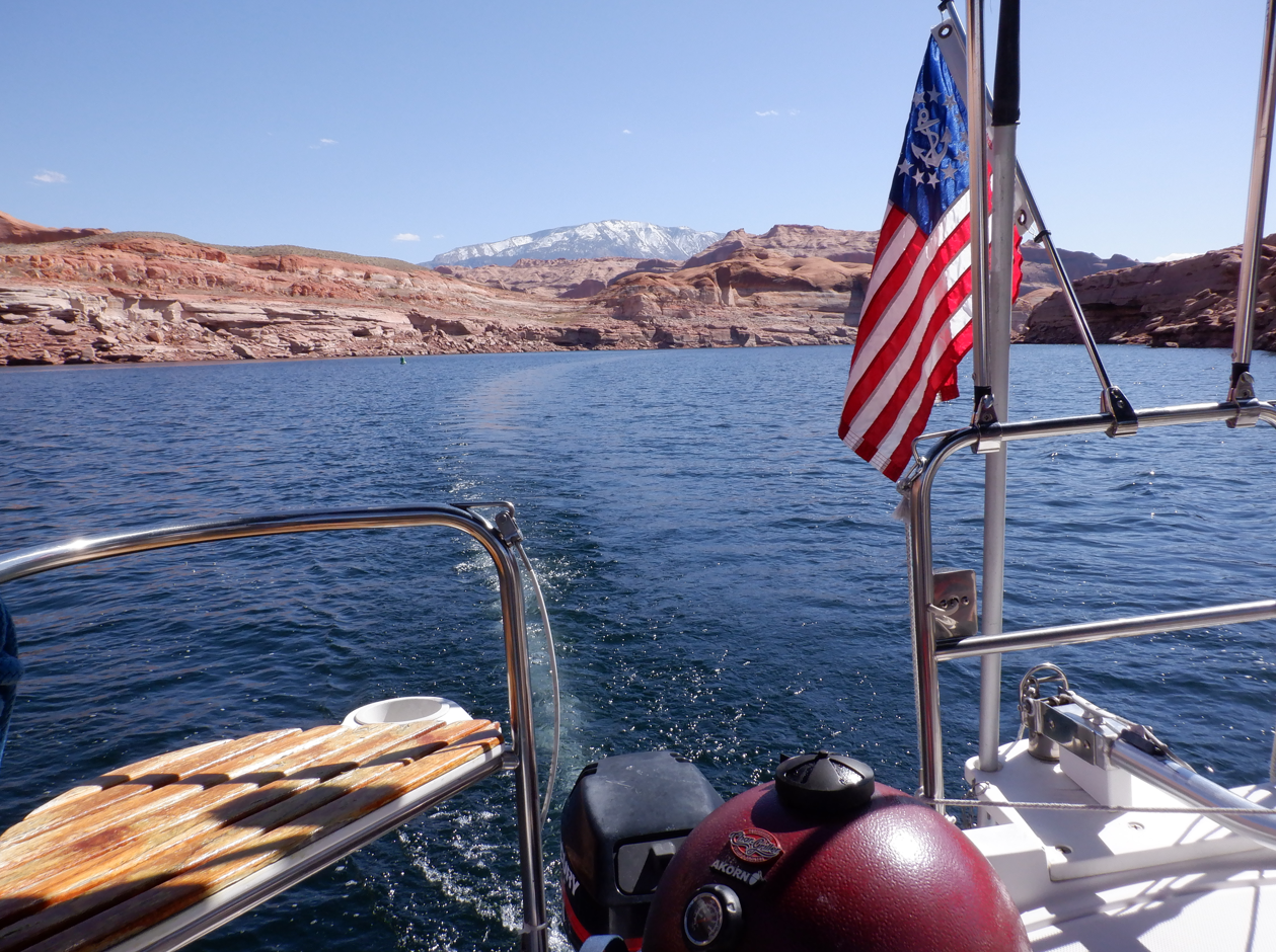

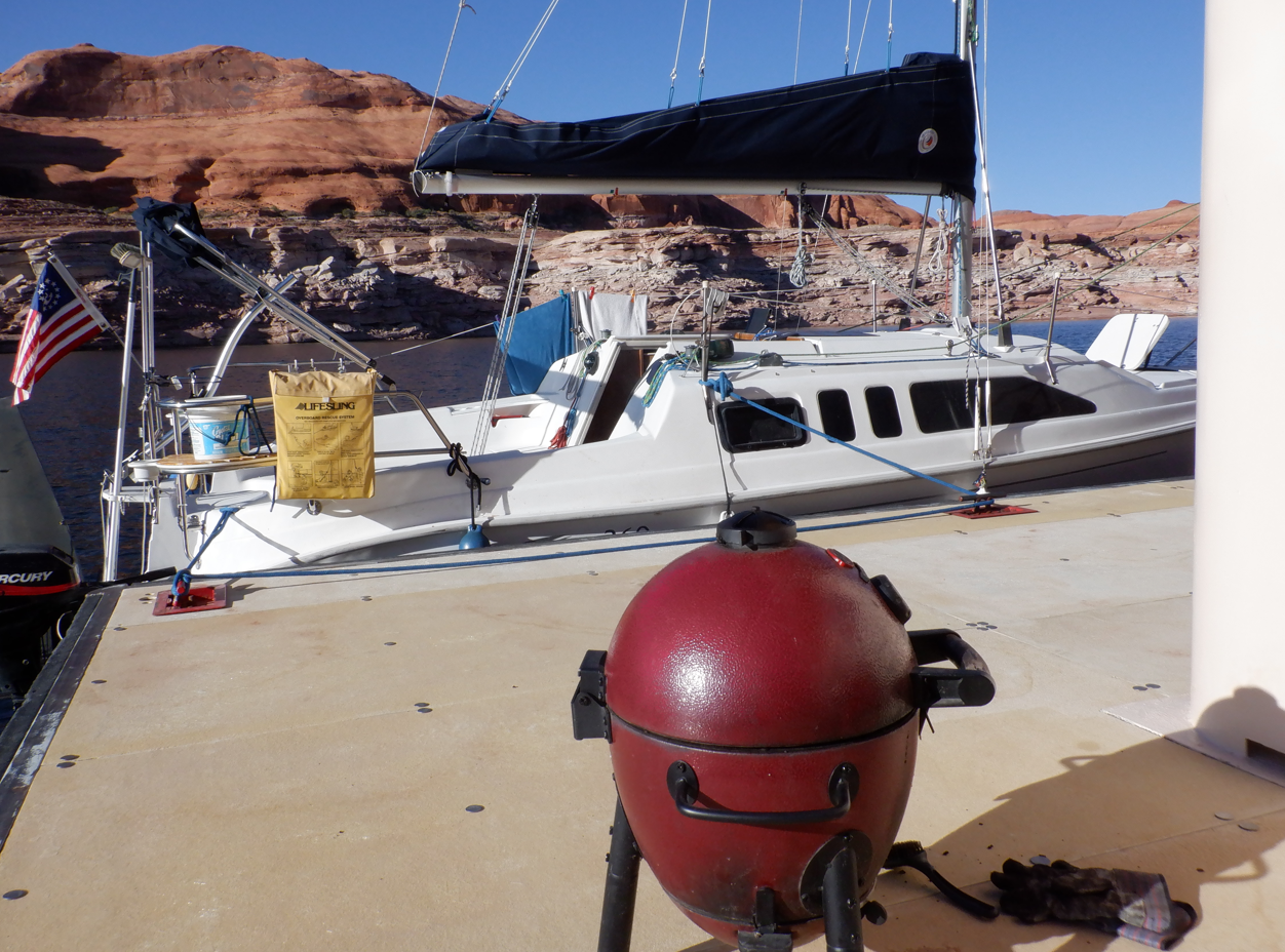

We did a nine day Lake Powell cruise in late March/April. My crew (Earl) was adamant re: packing his smoker (seen on the beach above).
Good choice. Worked well I think.
We don't need no 'stinkin outboard access.
