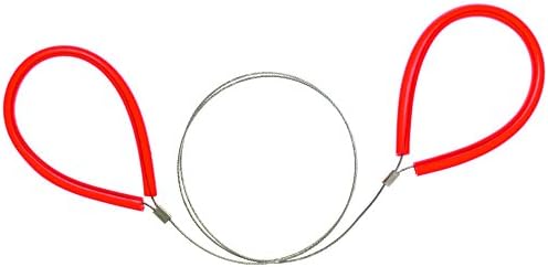

Someone will know, but I think you can use wire as a saw to cut through the caulk
I use one of these for plastic pipe sometimes
The problem is there is virtually no gap between the base of the winch and the deck
