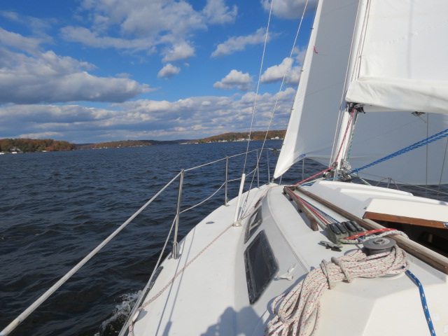

clutches ahead of winch
You also want to make sure the clutches are far enough ahead and oriented to allow a straight lead to the winch (pay attention to the side of the winch where the lines are wrapped). Ideally, you don't want more than 10 degree deflection through the clutch.
I have a gang of 4 clutches on each side so I compromise a bit, but I have it set up for the halyards to have the least deflection. You might find clutches for lines that are not intended to be led to the winch ... possible explanation for clutches after winches. For instance, perhaps the vang has 8 to 1 purchase instead of the standard 4 to 1. You could possibly avoid the winch and put a clutch closer to the cockpit.
(don't hang your halyard on the winch like I do - find a more seamanlike method for putting lines away! :redface:)

Before I installed clutches for my halyards... I had "vee" or "clam" cleats ahead of the winch so I could secure the line while I removed it from the winch drum and secure it to its primary cleat... which was behind the winch at the edge of the house. If you only have a cleat behind the winch, such as you have for jib sheets, then the winch can only be used for one control line. With an additional open vee cleat in front of the winch you can move one halyard off the drum so you can use it for something else.
