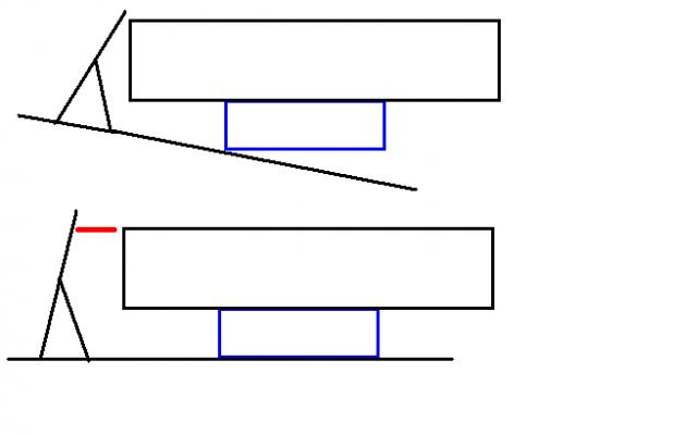

If your winch is anything like the original winch on my H23 trailer, it really just needs to be replaced. However, this is NOT a boat that you can drag up to the post - I'm sure you realize that. You've got to float it up - and even then it ends up not being all the way up to the post once you pull it out!!!
Becuase of the trailer tilt, the boat will always end up behind the winch post by a little bit (see picture). My current solution is to winch it up on dry land with a cme-along around the keel, but what I am going to do is install the winch farther back, with a 2-position bow stop, one for loading it, one for trailering.

This issue can cause lots of other problems. as you have probably noticed, even if the boat winches up to the post easily in the water, when you pull it out the winch cable is TIGHT. This puts a lot of stress on the bow eye, which is held in place with nuts on fiberglass. But worse - the U bolt is also the anchor for your forestay!!
I don't have a good answer yet, but I *am* going to figure out what needs to change so that when the boat is pulled up to the post in the water, it stays there while you pull it out! (A keel roller near the front of the bunks is one possibility. most of the keel would still sit on the boards, but the nose would rest on a roller. Doesn't help "dragging" the boat out of the water, but my gut feeling tells me it would eliminate the need.)
