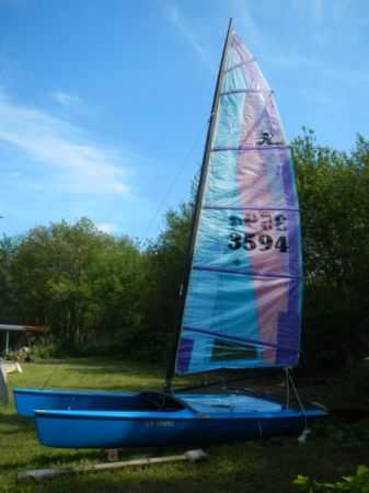

Let's assume that I can retrofit this 17' mast (from a 1988 Hobie 17 Catermaran) to fit my Mac 26' (Several people have said they easily retrofitted the Hobie 18' mast to fit their Mac 26).
The mast is 27'7 tall so it's almost the same height as the 28' Mac 26 mast.
So I will be re-using:
Mast, boom, rigging, sails from this Hobie 17' (so we know they all work together assuming I can get them on the Mac 26).
Will the sail area of the sail from this Hobie be enough to power my Mac 26?
If not, can I add a sail with more area or am I limited because i'm re-using the Hobie's boom length?
Also, will my Mac 26 trailer be able to transport this boat for an hour trip?
If no, has anyone seen any MacGregor 26 mast and sails for sale anywhere?

Hi. From what I found the sail area of a Hobie 17 is 168sq ft and your 26D is somewhere around 135 sq ft, so you would be gaining some sail area. The Hobie sail looks like it has a taller luff, which may interfere with your pop top. Also looks like the sail has more roach, which may conflict with your backstay (may not if the foot length is shorter than the 26 foot). Don't know what you are paying for the Hobie, but you can buy a new mast from Dwyer Mast Co. for about $750 (model DM-6) and they are located in CT.

Thank you! He wants $500 for the boat and sails. The new mast for $750 is a great deal, but I would still need sails after as I have none. I would also need a boom and the rigging, & I suspect adding these costs on would put me over $1,500 (due to sail cost)

One other very important factor is the aspect ratio of the cat main. While your Mac is mired in its boat hull speed determined by its length, the full battened high aspect sail is designed to take advantage of relative winds at speeds the cat hulls can reach. Unless you have found a way to go much faster than anyone else can, this main sail is not for you! Just sayin.....

Is that a fancy way of saying the shape of the sail of the Hobie is not good for the Mac 26? I wondered about that?

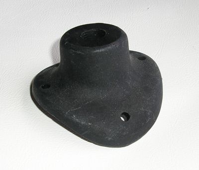

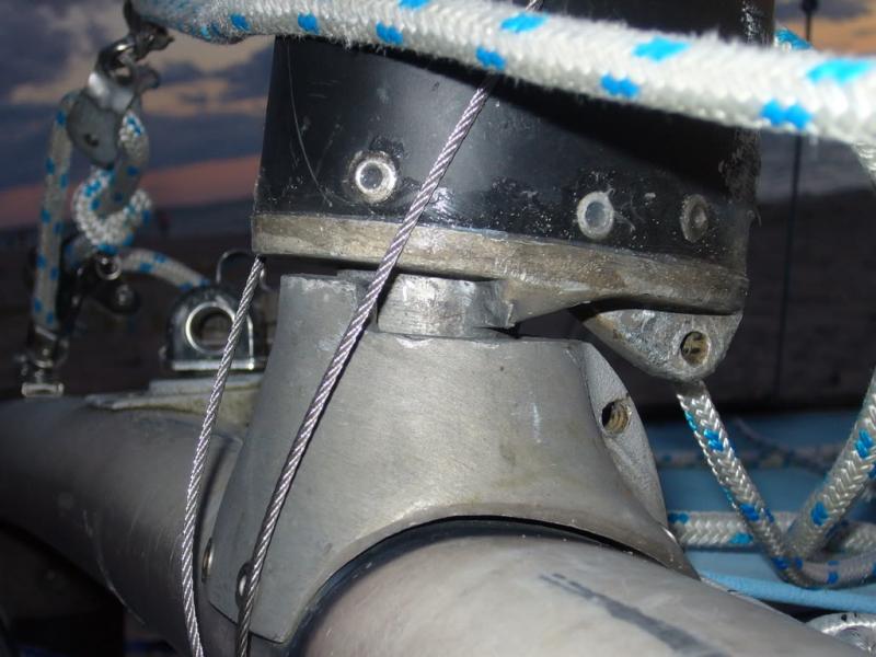

It is the mast step that allows rotation and some changes in the spreaders I suspect. A rotating mast was mounted on a 26 by someone on this board from southern CA. I just tried a cat sail on my 25 and found two things. I could not run it all the way up and have the aft stay connected And the second - it didn't have the battens - - - damn they are expensive! And this sail requires eight. Back in the bag it goes. I did have a smaller boom from a V222 that it fit better.
Take the whole thing and dump what you don't need later.

the Hobie 16 had a ball and cup setup where the cup was on the pontoon spreaders.
not sure how the H17 (getaway?) is setup.

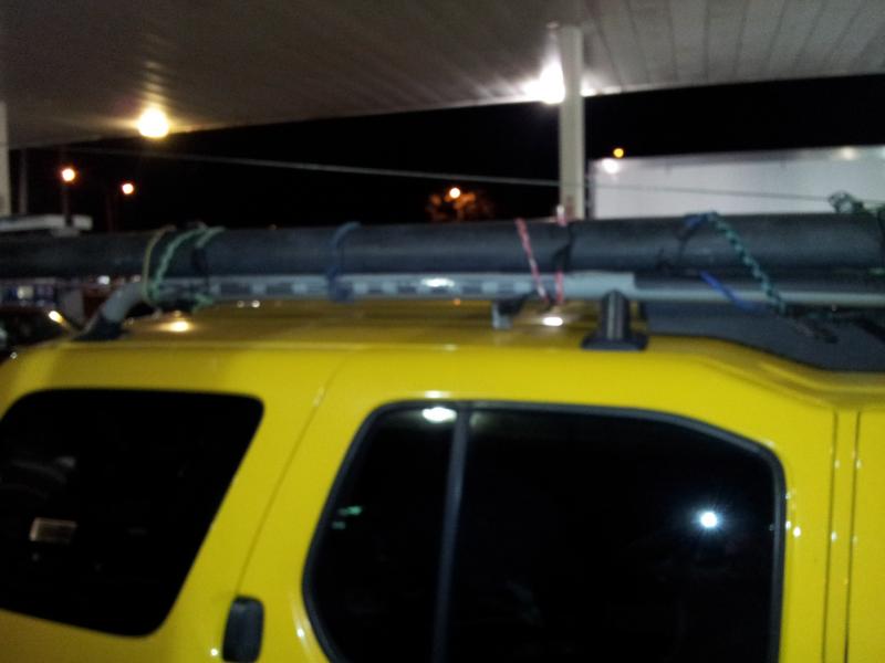

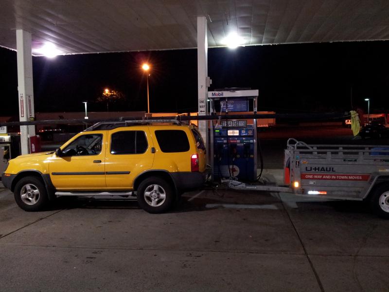

I read your answers and ended up taking every piece off it that I could. The boat I finally ended up buying was the Hobie 18 down in Philly, and I took off all the rigging and mast and boom and sail, and gave the boat and trailer away to a guy down there.
My 7 hour drive back to New Hampshire went pretty well, here's how I attached the mast to the truck, and I towed a Uhaul behind just for the safety of keeping cars far enough back, take a look at the attached pics and how it was only attached with Bunge Cords.
The last attached photo is what the Hobie 18 Mast Step looks like. Picture a ball that looks like a trailer hitch that fits into that socket. Notice the curved bottom of the Mast Step (because it's made to screw into a curved surface on the Hobie. How do guys who put these on their Mac's attach this curved bottom of the Mast Step onto their non-curved Mac?
Also, dumb question but, since this rotating mast just sits un-attached on the mast step like a trailer hitch ball, can this mast be secured enough on the Mac to make it not fall over? The Hobie Catamaran looks wider and better able to secure this mast from falling. Maybe I'm not understanding how this works?
