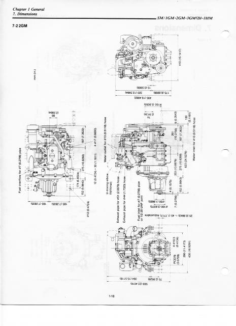

10,253
2GM Dimensions
Hope ya can read this one, GGrizzard.. Make a cardboard box this size and ya can tell really quickly if there is a major problem.. Like Steve says, I think folks do that refit .. Best of luck with the (rebuilt) engine
