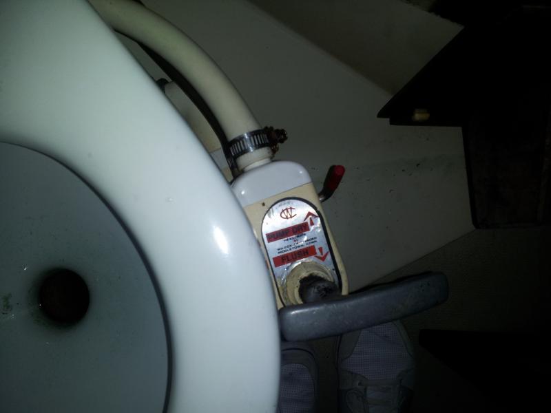

I am experiencing trouble with the head in my 1984 Catalina 30. The brand is Wilcox - Crittenden. When the switch is on either "Pump Dry" or "Flush", there is no pressure when pumping the handle up and down. Water is not pulled in to the toilet or pumped into the holding tank. The pump itself is very easy to pull and push. I made sure the seacock is in the open position to pull water in. It actually worked before but all of of a sudden it just stopped. I had a guest use the toilet and he might have flushed a paper tissue down there. I confronted him about it and he said "no". Hoping he didn't but I'm fearing he did. I've scoured the Internet but I can't seem to find instructions in troubleshooting. Perhaps someone out there may have some knowledge in this.

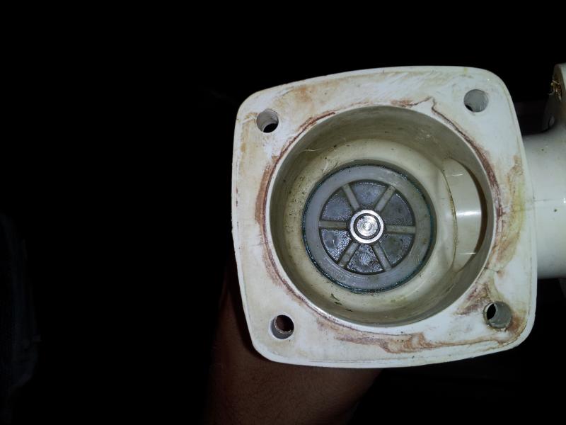

Hi all, I found this write up on the joker valve. This may help other's experiencing the same issue I'm having.
-Michael
JOKER VALVE 101By Vic Willman, Tech Services ManagerRaritan Engineering

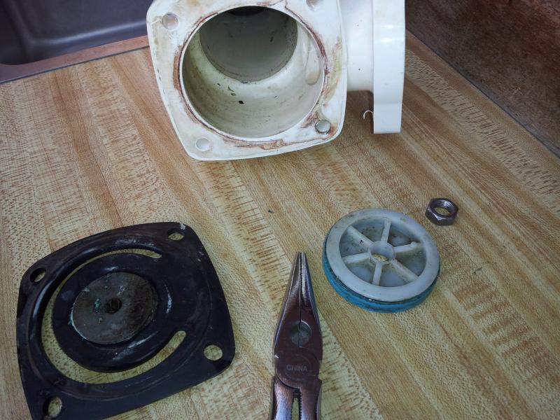

The water spraying out of the rod is due to the gasket and/or packing having gone bad. I recently tried to reseal mine, and the kit included a new washer and some packing material. If you decide to reseal the whole unit, you need to look the pump body over VERY closely. Mine leaked like a sieve after i installed the kit! Apparantly, the plastic pump body had stress cracks in it that I hadn't noticed before. When I tried to snug the screws, the thing leaked like crazy.
I have since received a new Jabsco head, and hope to have better luck with it!

Nice job. Good detective work. Loosen the nut on the shaft, find some packing material, insert it, replace the nut and you should be good for another couple of years. Then you can buy a Raritan, why go backwards to a Jabsco? :)
