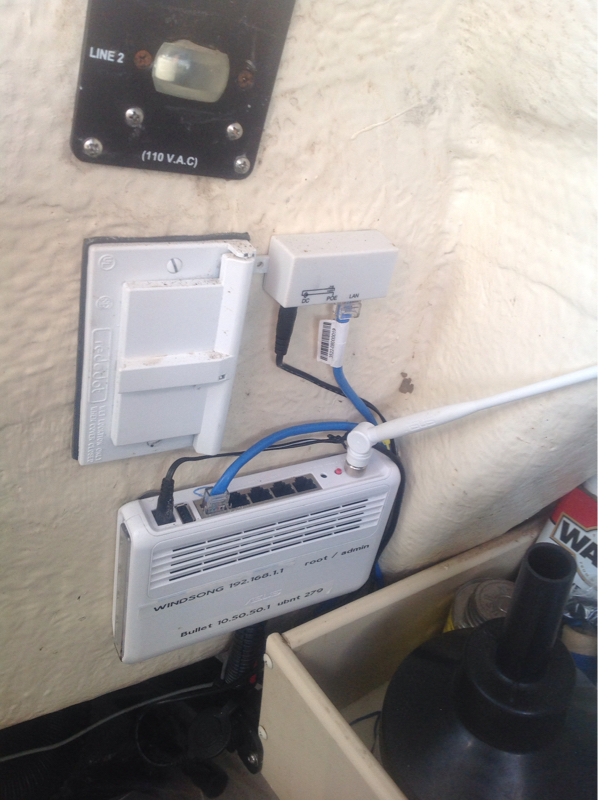

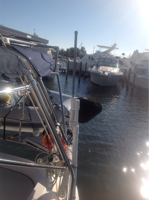

I put together a system using the Bullet and an old Asus wifi router. The bullet runs on 12 volts. The Asus on 5 volts, so I use a USB plugin for that.
It works well over very long distances. I have it mounted on a home made mast on our arch. The mast is telescopic so it does not shade the solar panel.
The bullet is not trivial to set up, unless you are very familiar with networks better to buy the off the shelf system.
Good luck, Bob

Excellent solution Bob. Probably easier to set up than the Alfa router I mentioned earlier.
