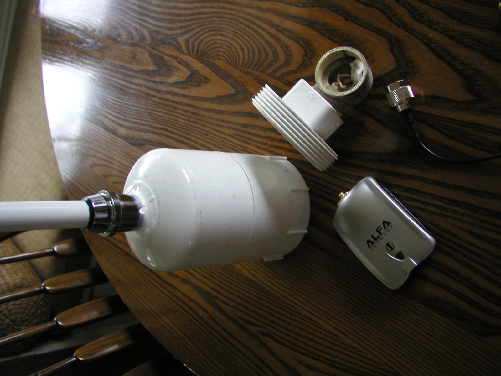

Made one several years back..worked fine but I got tired of the connection speeds, etc.. Now I use phone as hot spot for lap-top and have been really pleased. I use phone alone for most stuff, but some things are best with a real keyboard and screen.
I have a couple Alfa's like above that I use in motels and such and tried one of them side by side with the Bullet HP radio that I built for the boat. The Bullet will find connections the Alfa can't see and you will have better connection speeds with one and they last a lot longer out in the weather. More on the comparison here...
http://purplesagetradingpost.com/sumner/macgregor-navigation/WiFi-1.html
The Alfa is much easier to setup and use so they have their place and if one is in a Marina I'd try it first...
http://www.amazon.com/Alfa-802-11b-Wireless-Original-9dBi/dp/B001O9X9EU
... to see if it works as the cost is a lot lower.
