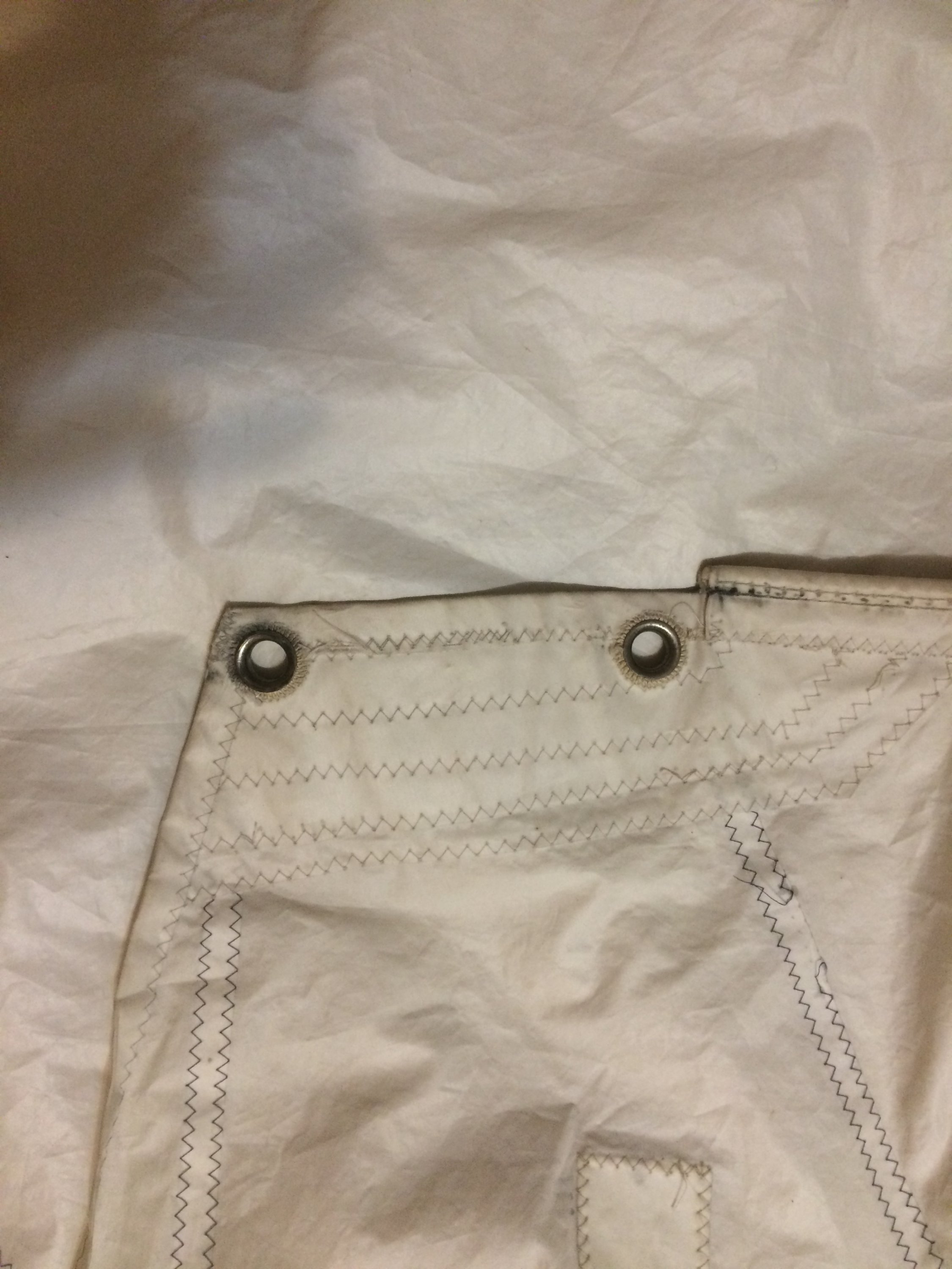

I am hoping some smart person can answer a dumb question for me. I acquired a late 70's Widgeon that was down on it's luck. After searching this forum and other websites I think I have the rigging worked out, but one thing remains. The tack of the sail has two grommets. Why?
It appears like the lower grommet has been used the most. The upper one is around 6 inches higher up and has seen little use. Is it to provide a flatter sail? I do not know if the sail is one that originally came with the. It is an O'day sail made by Neil Pryde.

I would venture to guess it's for a cunningham.

Cunningham, never have used that on either my old WIDGEON or my present DS II, but both had the extra grommet. Seems to me that the halyard and downhaul for the sliding gooseneck would mostly provide the same adjustment ability as the Cunningham. If gooseneck was fixed in place on mast (didn't slide) like on some other classes, then yes, I see the purpose of the Cunningham grommet.
If your sails are labeled "O'DAY" and made by Neil Pryde, then they are either original or OEM replacements.

It has been a long time since I sailed a Widgeon. Not even sure Reagan was president yet but I seem to remember a line looped through those cringles to tighten the luff.

It's for the Cunningham. Even with a boom downhaul, a Cunningham is way more effective because it doesn't pull on the foot of the sail. When you rig the boat, tie off the boom downhaul to stabilize it. Look on the mast for an existing eye strap on one side and a small cleat on the other, use 1/8 or 3/16 line. That'll give you 2:1 with no fancy hardware
